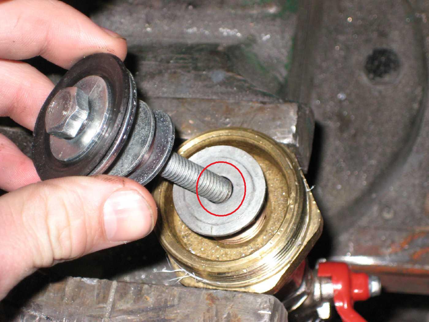

to show you abit i throws in a pic of my piston.
Edit: ignore the red ring

shit thats almost like mine. i wish i had a cam but the front of it is bassically the same but i have another sealing face on the back and it is sleaved inside a 1" pvc pipe. nice

this piston worked so well because:
1. the sealing face bent forward when filling so it filled up fast, and back when piloted to seal.
2. it was light
3. it har a "seal" at the back
4. i use another one now
