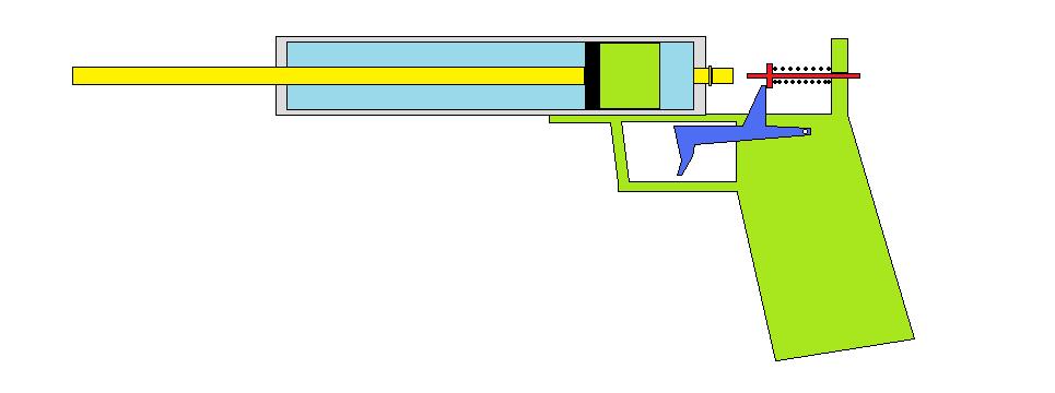

flamerz14 wrote:what do you mean by
if I were to put a hammer that strikes the schrader valve stem
Something like the attached diagram, pull the trigger which releases the spring loaded hammer, that strikes the schrader allowing the air to escape thus piloting the piston - et voila, hammer valve pilot :)

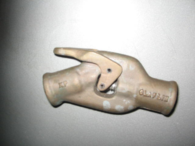

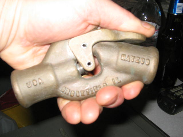

nivekatoz
Posts: 237
Joined: Sat Nov 25, 2006 7:05 pm
This valve I think works on the same idea, only with more volume. Its 1/2" npt. when you press down the lever a piston type thing opens just like the valve in the video..
