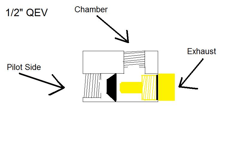

Ok, i bought a qev one ebay, and once i got it, i tested by blowing on the chamber side and sealing the pilot side with my hand. As i expected, when i moved my hand i could blow through the valve. I do it again, and it turns out when i blow into it, the valve hasn't sealed, and have to blow into the plot to get t to seal. Then i can do the test i first did. So, my question is, should it be sealing without me having to blow pressure back into the pilot side? The only thing I could think to do that would fix this, would be to put a spring between the piston and the pilot hole. Does anyone understand what i'm saying, or did i miss a day of QEV school?
crappy MSPaint included
qev sketch.jpg (27.01 KiB) Viewed 3554 times

Blowing manually though any port does not = valve testing. It needs more pressure than that to work properly.
Also, you're blowing air in from the chamber. It's not meant to be like that.
You pump air in through the pilot and that seals the valve as the chamber fills up.

I had the exact same problem as you. My pump doesn't have enough flow to get it to seal, so I made my own spring for it. Just a little bit of wire, coiled in on its self(like a battery spring, so it takes minimal space.) I just had like one wrap, with the minimum spring, so as to have the least force necessary holding it closed, so that it will still open easily.

A QEV needs to be filled from the pilot side. When your airflow is not big enough to get it seal, a spring can do the job.
Also, when you use a spring and puncture the piston (equalisation hole) it is possible to fill it from the chamber side. (BTB made a gun like that)

anyway.... you have to fill and pilot QEVs form the pilot side that's it... you would have to make a small hole in the piston/diagraph to fill from the chamber side

yeah, i've been looking at all the QEV guns on here for a while, i guess i never realized you fill from the pilot side...
