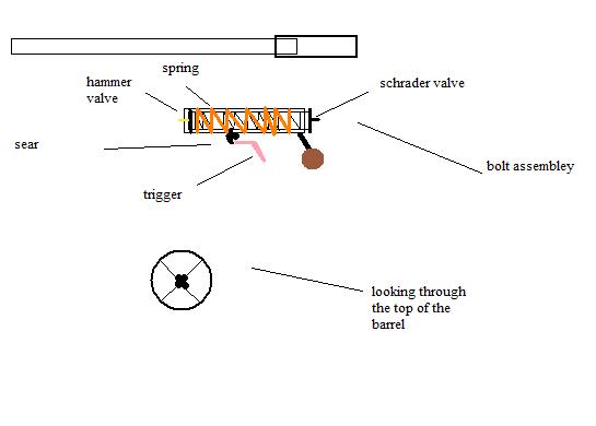

I have been thinking alot about a new un-used design (to my knowledge) and I came up with a pre-charged pneumatic bolt. basically, when you pull the bolt back it cocks the cylinder inside. at the end of the cylinder is a hammer valve, when you pull the trigger and release the cylinder, the hammer valve hits a piece of steel bolted onto the barrel and releases the air into the barrel. Simple: fairly, but the idea still needs more developing.
Tell me what you think... and ask questions

- This is a 5 min. paint diagram
- pre charged bolt.jpg (16.29 KiB) Viewed 1615 times
- when it is cocked
- pre charged bolt 2.jpg (17.11 KiB) Viewed 1609 times

That's cool I think I will take the credit for that just kidding I want to try this. Maybe you could have a crank and a loading mech so it could be full auto or maybe you could just have a air compressor hooked up to the back of it so you could have almost endless shooting .

This works very similar to Ant's hammer valves, only reversed.
It will work.
It will work.

I will probably start to work on this next weekend when I'm done with being a councilor anyway...
need more feedback
