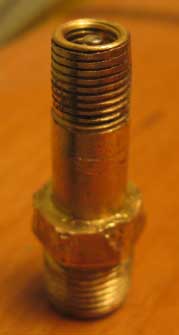

Ok, i am going to buy the parts for my planned pneumatic and I decided to try to salvage the schrader valve from my first attempt. After trying many things (wrench, clamps, etc.) in hopes to break the epoxy, I decided to use a blowtorch since epoxy is heat-sensitive. Anyway, I'm not sure if it's safe to use or not so I figured I'd ask. As far as i can tell the (bottom) threads are ok and the valve functions, I'm just making sure there isn't something I don't know about.
This is it.
This is it.

It should be fine.

What pressures do you plan on running it at?

Posts: 575
probably 120 psi max

Your defiantly ok. Even if it broke on the inside when pressurized you'd probably just get a bad leak.

It should still work well, but the heat from the blowtorch may have melted the rubber seal inside the valve. You may need to get a new valve stem for it. (You could just take the valve stem out of a bike tire or other schrader valve.)

Ummmm.... What's a new schrader valve cost... $2?
