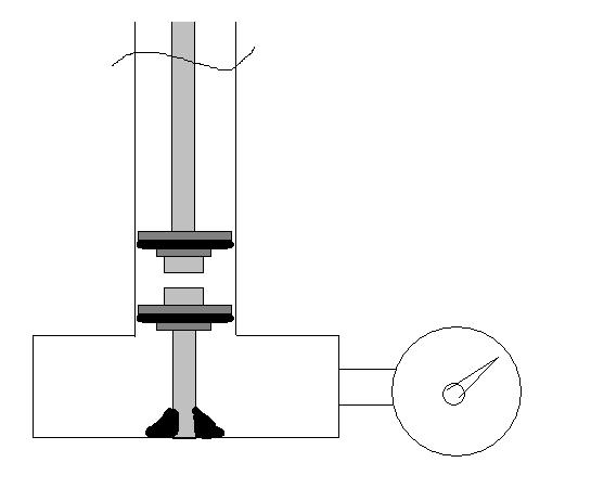

To get a check valve that could withstand that sort of pressure, it would cost alot and if I used a low pressure valve, I might get a blowout out BTB did and possibly kill myself... So I came up with this idea. It's a floating o-ring check valve. My guess is it that would be very hard for it to fail and it could handle alot of pressure with ease.
...and not to mention it being stupidly simple to constuct.
I'm going to use a galvanised T with the main check valve bolt mig welded in place. To get the bolt in the perfect spot will be the hardest part. I'll construct the whole check valve, sit in it place inside the chamber, do a tack, make sure it's correct and then really go over it with a thick bead of weld.
Please tell me what ya reckon guys :)
it's a pretty sh!tty diagram, but I just wanted to show the main parts of it.

stupidly simple check valve.JPG (13.96 KiB) Viewed 4111 times

so to put it the more understandable way: if this pump get a 22mm main cylinder, your valve would have to hold about 1140kg on 500psi.
that means you have to trust your weld to death.

Nice to see everyone commented on the check valve idea :D hahaha. The schrader valve would be good but I don't know where to find a bolt on/threaded valve. Plus, I like to be inovative and use what I have to make something phenominal that's never been done.

1/2" type L has an id of .545". At 800psi this will require a force of ~187 pounds. (85Kg)
1/2" type M has an id of .569". At 800psi this will require a force of ~203 pounds. (92.3Kg)
Consequently, this is also the amount of force trying to "remove" your check valve.
A few comments on the design;
You need to incorporate something to limit the travel of the o-ring on the down stroke. If it moves too far, it might jam up and not come back to seal. (Pump handle in the face syndrome.)
I like serviceable stuff, could you weld a nut into the bottom? This would allow you to "unscrew" your check valve to replace the o-ring.

Yeah definately Geppito, serviceable equipment is always good when you make alot of mistakes like me :D. To limit on how much the o-ring moves, i'll make the grooved washer on the bottom, only a fraction smaller then the top sealing washer so it flexes only enough to break the seal and allow the air through. The nut on the idea sounds like a top idea as opposed to welding the bolt straight on.
