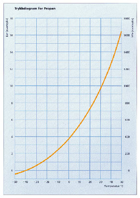

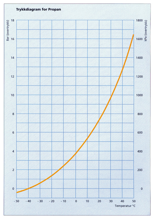

The highest mix you can achieve depends on the temperature.
At 70*F the vapor pressure of propane is 110psi. This means with a partial pressure of roughly 4%, you are limited to 2800psi, or around 190x, before any extra propane turns to liquid.
Of course building a cannon that can hold 2800psi is a bit of a challenge in and of itself. Trying to ignite a mixture that is at that pressure is something else entirely. It is 'possible' to build a launcher to contain this, so there's your answer, but I wouldn't hold me breath on seeing one.

Of course one can see from both SpudFarm's post and mine as well that the ambient temperature is the big factor here. While a person in one part of the world may be limited to 120x, another could achieve twice that just because it's a warm day.
But, it doesn't matter if no one is willing to take up the geometric increase in cost that is associated with an arithmetic increase in performance.
