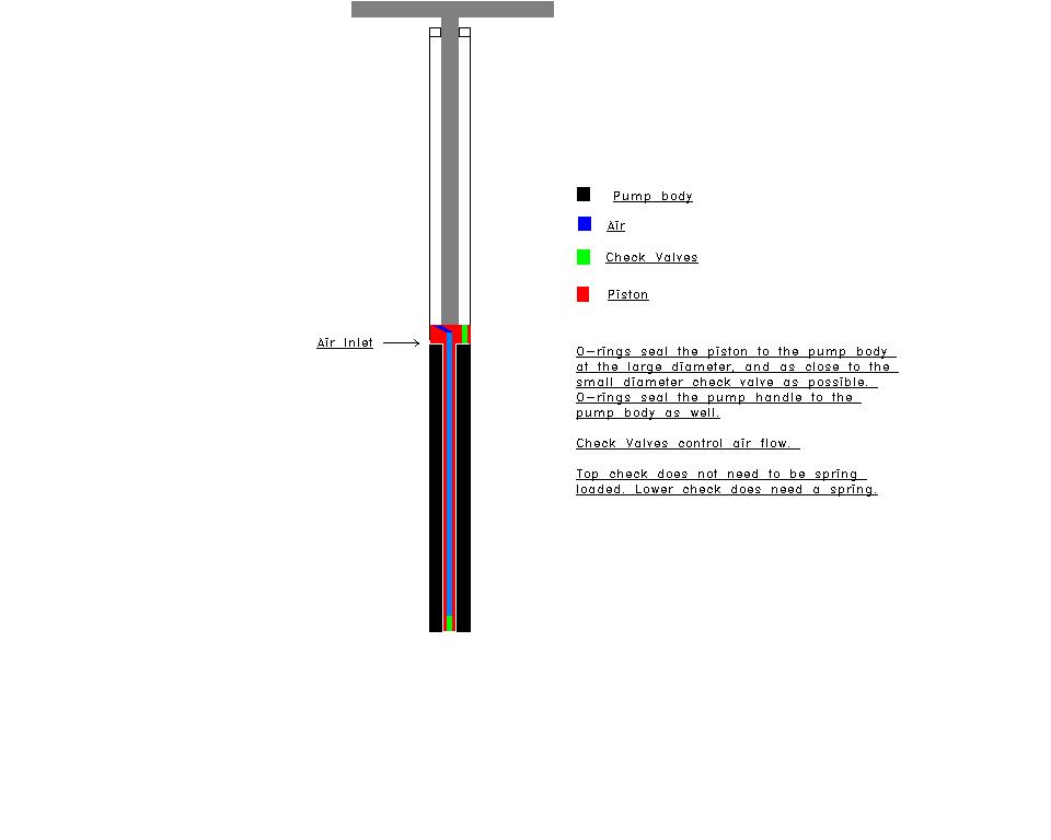

This pump was designed with the non-lathe owner in mind.
With a lathe, you should be able to make several improvements on this simple design.
http://www.spudfiles.com/forums/easy-st ... 13277.html
Edit: And I did take a schrader to 300Bar.
Thread is here:
http://www.spudfiles.com/forums/the-fai ... 15393.html
I am looking for a pump that will hold a minimum of 60 bars... wich is in fact double the pressure you used.. so I kind of did not try it..Gippeto wrote:Did you check the "How-To" section? Guess not.
Thread is here:

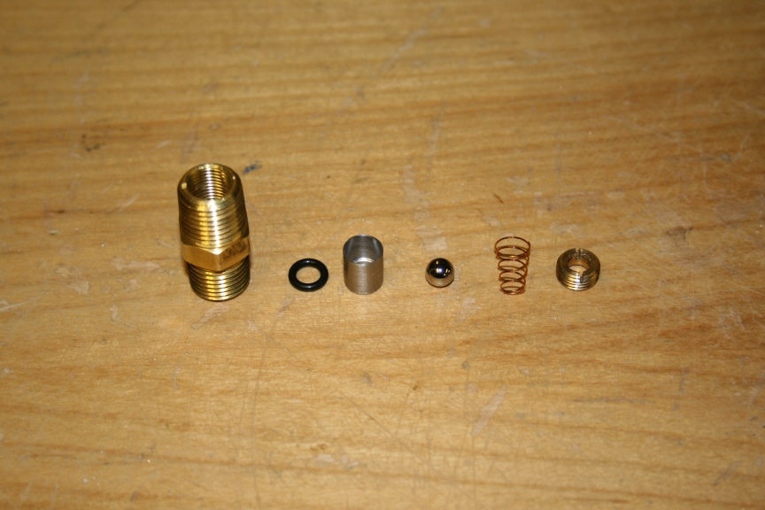

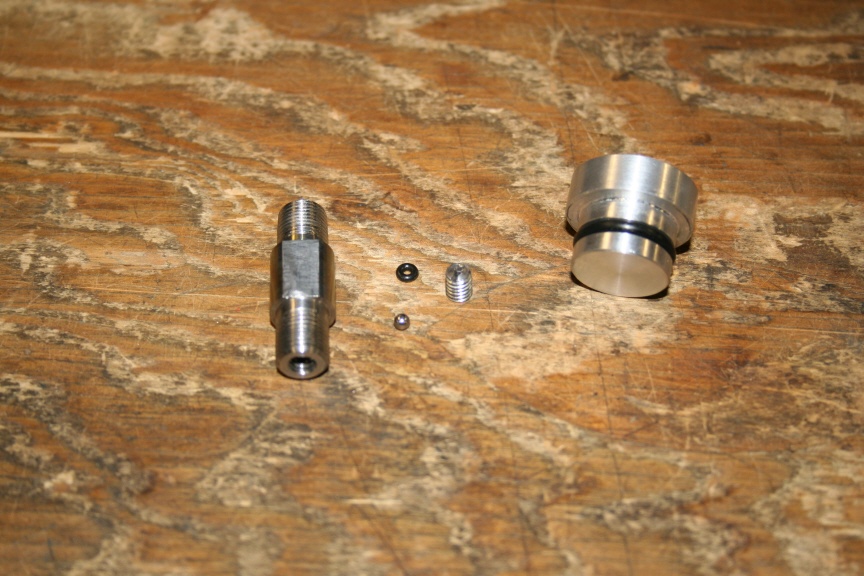

I understand.
This was the check valve I first built for the co-ax. Burst pressure of 9000psi using yield strength of the material (316 stainless).
Threads are 1/8"npt
The ball is 1/8", the o-ring I believe is an 005. The plug is hollowed out to allow the ball to travel slightly. It also "retains" the o-ring in place.
Edit: Almost forgot, you will have to add a spring to use it in a pump.
Threads are 1/8"npt
