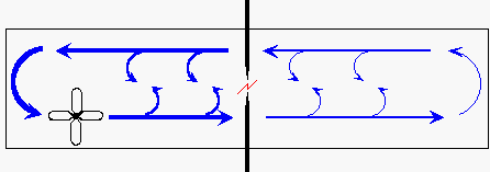

The affect on fan size, relative to the chamber diameter, has been discussed before. It seems to me that you want the fan diameter a fair bit smaller than the chamber diameter. If the fan is nearly the chamber diameter then the gases in the chamber really won't move much with the fan on since there isn't an effective recirculation path from the front to the back of the fan. A large fan won't mix as quickly and it won't provide as much turblance during firing as a smaller fan. I would say a reasonable "best guess" would put the fan at 1/2 to 2/3rds the diameter of the chamber. D_Hall suggested the area of the fan blade should be about half the area of the chamber, that puts the fan diameter at about (chamber diamter/1.414). That would be a ~2" (50mm) fan for a 3" chamber.
- Small fan, offset from chamber's central axis, may give a significant recirculation path with substantial turbulance where the two streams pass each other.
- small_fan_turbulance.gif (2.77 KiB) Viewed 3073 times

what if you added another fan to the top right hand corner of the chamber in the diagram above?
The two fans would blow towards each creating more turbulence. Might be something worth trying.
This seems to jive very well with my own independent/non scientific tinkering. I am in the process of fitting my larger gun with a small fan to accompany the larger fan as the chamber is pretty big. I just might try pointing them at each other.jimmy101 wrote:

The only problem with this setup is that the barrel end fan may well get trashed by the movement of the combustion gases. The barrel end fan has to survive pushing the gases towards the center of the chamber then getting forced to reverse direction as the combustion gases race down the barrel at perhaps a couple hundred miles per hour. Then the ammo exits, the pressure drops, the temperature drops, the pressure drops below ambient and you get a high velocity surge of air back into the chamber, which reverses the fan direction again.daberno123 wrote:what if you added another fan to the top right hand corner of the chamber in the diagram above?
Plus, when the fan dies it'll be a pita to replace.
EDIT: Radiation, sounds like a great setup. Can you get muzzle velocities with the big fan vs. the small fan vs. both fans?
