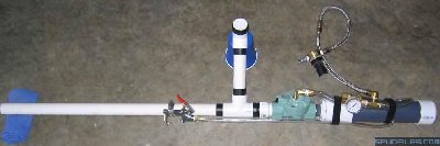

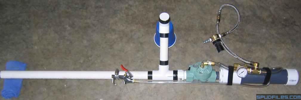

Here's a side view of the cannon. In case you're wondering, the black tape is cosmetic, hiding the blue cement I used...no, its not taped together!! ;) <br />Also, as you can see, the air system plugs into a compressor with an industrial plug. The regulator you see is a detroit pneumatics mini-reg I got for free. I love the look of those braided steel lines (also free!)

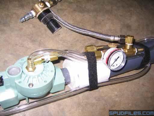

Closeup of the valve assembly. If you notice, only two screws are in the top of the valve (I forgot to replace them before taking this pic...I was previously showing off the internals of the valve to a friend)

Darn... I just had his idea the other day and thought I was the first one :( . Good work though. I reckon i will make soon a 3-5 chambered, single barreled cannon. The only thing i can find that wold be dodgey would be the size of the chamberes, as the gun needs to be portable. I hope to have this built within the next... :roll: year. :) It will take a while and must be a secret bye!
---Julz
spudshot
Posts: 1036
as far as arranging the chambers to be portable julz, you could just use elbows to make the chambers go the same way as the barrel, so all you have is a cannon slightly longer than the barrel

aaah! how do you make the sprinkler valve work with the blowgun, I can under stand if it just releasis presure.
spudshot
Posts: 1036
there is pressurized air on both sides of the diaphragm, using the blowgun you exhaust the air on top of the phragm, so there is no pressure above, and your chamber volume is still pushing from below, that pushes the phragm up and allows the air go to to the barrel

i honestly dont know how this gun loads. and i dont get y there are 2 hoses coming from the valve, those clear hoses dont take a lot of pressure.

Neat! But you need to elaborate on your system there. The valves and loading.

How does it load for semi auto??
