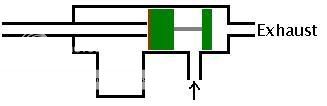

Hey guys! Just a quick question for you and hopefully some inspiration if there is anything new in what i am presenting.
The air input in this design is the vertical tube at the bottom, where there is an arrow pointing into it. By leaving constant air flow through the input, can i achieve a semi-auto piston by opening the exhaust with a solenoid valve for a second and then closing it?
I fear that the piston might not actuate if my pilot as less flow than my barrel. What do you guys think? This is a for piston semi-auto design, loosely based on a spool valve design (obviously the bolt part in not drawn, i'll keep it for later :wink: )

It would probably work, but it would be easier and most likely more efficient to just hook up a 3-way valve for the exhaust.

@ Leonard: I think that looks like a great idea. If you can get a good seal between the exhaust vavle and the input valve with that piston, I think it'll work. The extra pressure from the air source might actually help push the piston forward if it can't get behind it.
EDIT: With the three way valve, how would you use it? You'd have to turn it one way to put gas in, and turn it another to get gas out right? So your entire trigger action would involve 2 turns, right?
I think a better investment would be to simply use 2 valves. For my design, I'm considering using a blowgun to allow propane into the gun triggered by my left hand and a blowgun used to trigger the gun in my right hand. It'd still be 2 actions, but seems a bit easier to use than turning the same valve twice.
Or you could just use the design you already have planned out and hope it works.

noob of noobs wrote: EDIT: With the three way valve, how would you use it? You'd have to turn it one way to put gas in, and turn it another to get gas out right? So your entire trigger action would involve 2 turns, right?
Spring load the 3-way valve so you only have to pull it in one direction, then you just release to recharge the gun. http://www.spudfiles.com/forums/semi-auto-t160.html
Or you could use an electronic 3-way with a momentary switch for even faster actuation.

Thanks for the help guys. I could surely use a three way solenoid, if i wanted to build a gun that would cost over 200 bucks to make. Im basicly working on the most efficient semi-auto design V.S. lowest cost and number of tools required.

One of the downsides to this design is that you need to rely on an restrictive equalization hole (or piston blow-by) for filling. With a 3-way valve you can put a check-valve in the piston to create fast fill times, however with this design increasing flow to the chamber side may cause some valve seating problems and probably a further loss of efficiency.

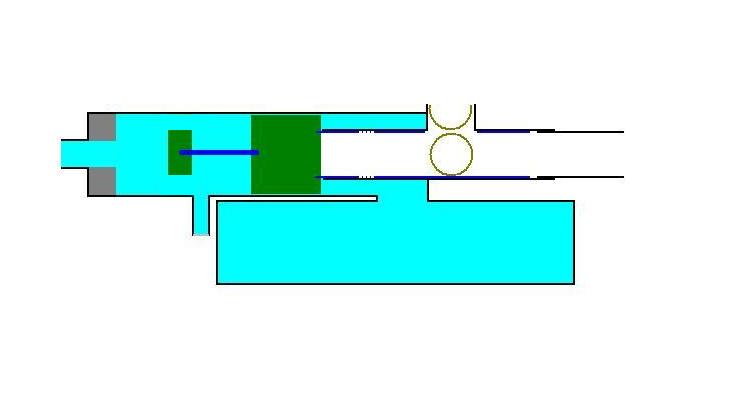

I get where you're coming from. But, considering what are my goals, i'd like you to take a look at the full design, including the bolt :
This can be completed with four part :
- 1/2" copper pipe
- 9/32 brass pipe (barrel)
- 10/32 brass pipe (perfect fit around barrel)
- Epoxy

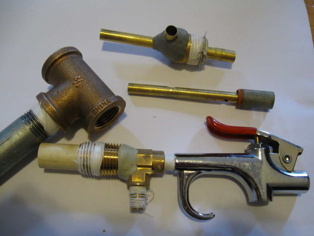

I've already made a working prototype of the piston/bolt that worked with two blow gun. One to fill and one to pilot. Slow firing since i had to depress the fill blow gun and press the pilot, but it worked pretty well! Here it is :
So basicly im just looking into upgrading the working version i have with the pilot method i am describing in this thread. I managed to make the first prototype for under 20 dollars (excluding c02 fill system, obviously) and i had satisfing performance.
I can understand that this design would be hard to get to work properly, but i just dont wanna copy your ideas as i have done in the past. I came up with something relatively new with the prototype i just posted, i'd like to get it to work even better (full auto with a pop-up as pilot and blowgun as fill). Sharing the results with the spudfiles will be more satisfing if i build something new ^_^
Thanks for your help, trow in some feed-back on the pilot im presenting.

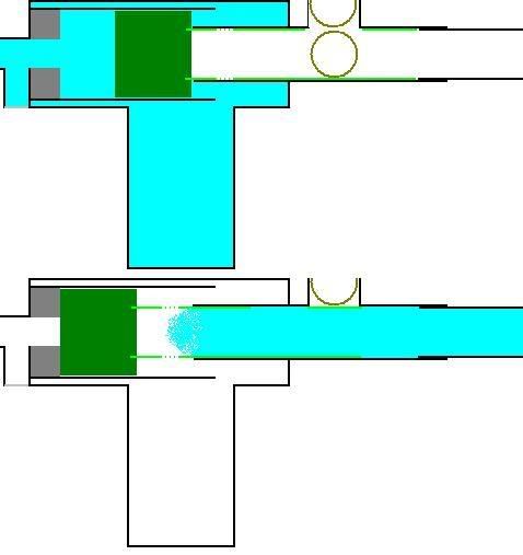

I understand the need to innovate, though If I could make one suggestion, a smaller secondary piston as shown in the attached diagram would make it much easier to re-seal the piston.
Alternatively, you might want to consider making your own three-way-valve-on-a-budget using an ordinary ball valve and a drill ;)

And my drawing of a possible set up, using brass fittings (not very easy to get pressure PVC in France).
A washer and a spring would go between the pilot valve and the piston, to push it forward.
With this set up the main chamber or filling port, is on T no1, so the only action needed to fire is the opening and closing of the pilot valve.
