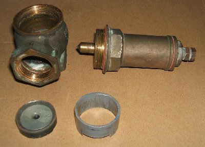

You might remember a couple of months ago I got my hands on a lovely surplus 1" pop-off valve. Well, I finally got round to modding it and here's how the testing went :D Ignore the random fittings, I was just in a hurry to hook it up to my compressor...
Note how as always, altering the flow alters the rate of fire. My cellphone's noise filter refuses to show how ear-splittingly loud this is!
Anyway, expect a marble autocannon soon ;)
Here's a pic of the mods I made, basically a 40mm PVC insert with an appropriate outlet cut in and custom cast epoxy/rubber piston reinforced with a steel washer.

Here's what I have so far, I'll test the valve and chamber combination later today and the barrel/magazine setup tomorrow.

I've shortened the chamber to about 25% of the above, as the flow wasn't sufficient to cycle the valve at higher pressures. Testing due some time tomorrow evening, watch this space :)
