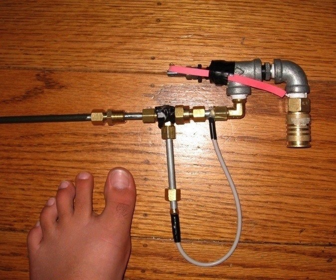

Here are some pics and if you need any more info, just ask.

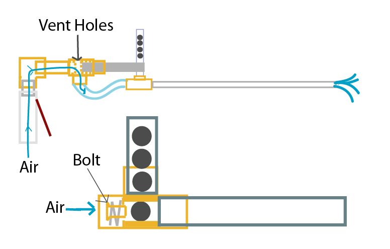

Here's a diagram
Here's a diagram

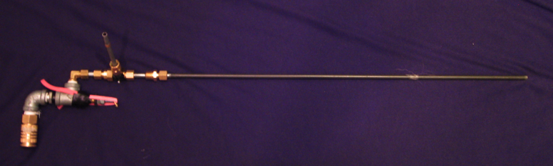

The full gun in all it's glory...

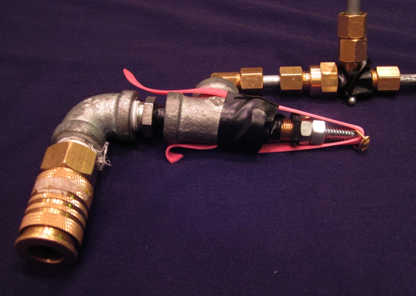

The ram housing, ram and bolt housing, please excuse the tape, this is only a prototype (but could be refined).

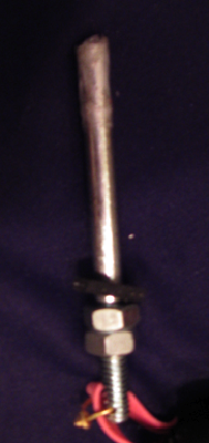

The Piston/ram thing, notice the rubber bumper ring and bolts for adjustment
interesting design... why have you built it in this way ? to lower the ROF?
it seems to that it could work better if you use a strong spring instead of that rubber band and/or get a heavier ram

from the diagram it appeared that the ram goes into the mag.... but it doesn't :shock:
@alihisgreat yeah I've noticed that too... interesting...
@kablooie are you planing to have a bolt operated by the movement of the rod ?? that's the first thing that came to my mind when I saw it

Wouldn't a light ram be better in a piston since the lighter the piston the faster it recipricates? and the faster the velocity the ram is moving at transfering the energy into the bb?

his piston/ram failed becasue it stayed in an open position - it didn't reciprocate (is it the right word ?? :D ) I see that your does the same occasionally but I suspect that it works better than his becasue it has greater mass....
if it's not a problem could you experiment with it by adding more mass to the ram/piston - just to see what will be different
