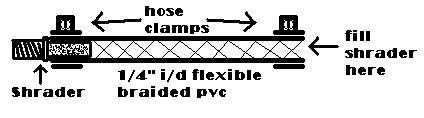

Make a adapter. Get a lenth of 1/4'' i/d flexible pipe that is braided, a tubless tire valve striped of rubber, and two hose clamps. hose clamp the hose onto the the air out side of the shrader not the fill side of it and you are done hook the pump onto the fill of the shrader on the adapter and hose clamp the hose onto the shrader that is on the gun wan't a diagram?
