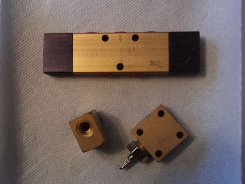

yeah most 1/8" valve will have too little flow... possibly clippard's MJVO-3 is good enough but I can't test it
alternatively you can use an aux. QEV to pilot the main QEV
I tested this with a 1/8" QEV that you can see in the pic below and it works great
