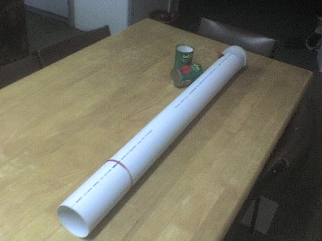

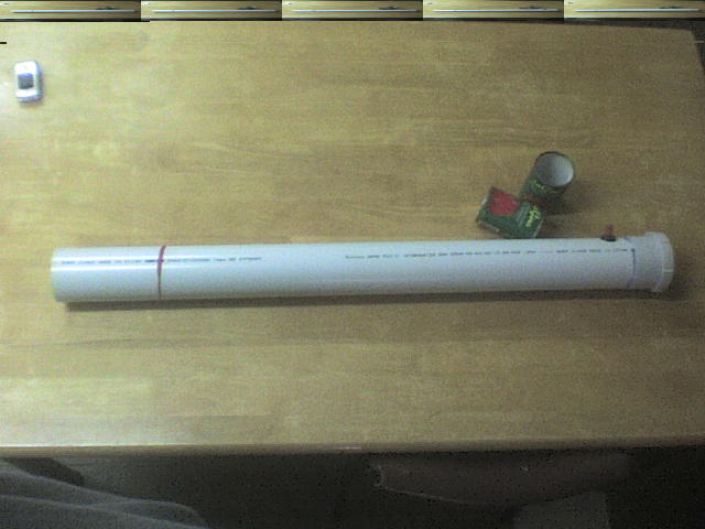

Hey Gyz, I am New To "Spudfiles"
This is my very first spud gun
i think it looks pretty cool but tell me the truth bout it
if you have any ideas on what color i should
paint it or make any mods on it plz say
thanks

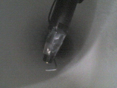

this is the interior of the gun also showing the other end of the BBQ ignition

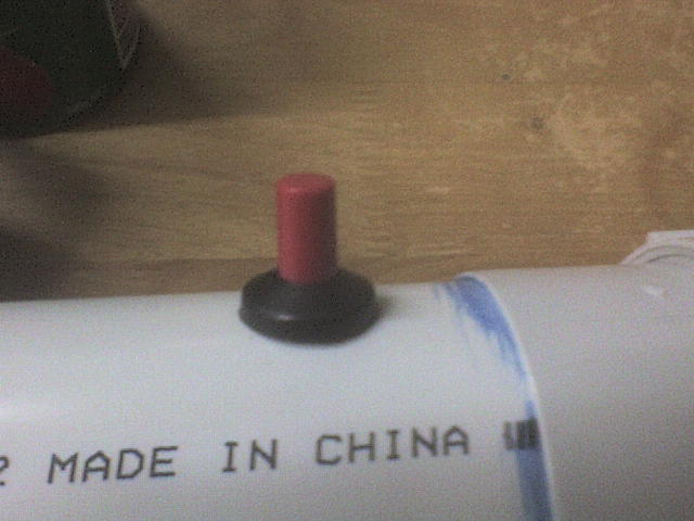

this it the button on the BBQ igniter i used

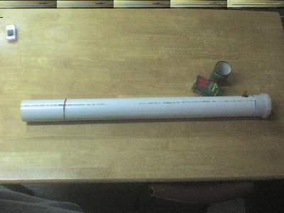

this is my spud gun
this is my spud gun

That is eerily similar to my first, but better constructed :D The only issue I see is fueling. It might be hard to get the right mixture in that size of chamber if it is spray and pray. You'll probably find something that works, though. Nice first build! For the future, think about a chamber with a reduction to the barrel.

It would have been a bit better to tap a hole where there's more than one wall of PVC, bt still not bad. What's the diameter, 3 inches?
psycix
Posts: 3684
Location: The Netherlands
Looks good.
The less fittings there are, the less fittings can fail. Simple and safe.
How far do you shove down the ammo?
In other words: Whats the C:B ratio?
The cool thing about this gun is, that as long as you dont build in a "spud stopper" (a bolt to prevent the ammo of going into the chamber), the C:B value is variable and you could find the optimum for different types of projectiles.

Hey Gys the diamater of the barel is 90mm idk hw much it is in inches cos i use cm and mm i tested it today and made up somee new ammo cos the cas were too small so i got a roll of toilet paper and teaped it u with duct tape it shot approxamaty 132meteres i shove the ammo about 30mm from the back it has good compsression and i will soon post a video on you tube for you dsnt need much spray to go far
a bit loud tho XD the nehbours called the cops coz the thought i wass shooting the wildlife of sufin
any ideas on paint and modding would be great
thanks

like my "one tube" design, yet to be made. you only need to make a "stop" to define the barrel and combustion chamber.
drill a hole where you want the barrel to end, insert a bolt and nut as a "stop".
it is a simple design, and it should work well, just figure out you C:B ratio.
KUDOS on your KISS design.
(i'm unemployed at the moment, food comes before fun, i will do a few videos tomorrow, try out my "pea shooter" barrel, 2.33:1 C:B ratio, should kick major a$$.)

mateee nice build. im not usually in to combustion, but yours caught my eye.. i havent seen a cannon with no chamber reduction before :wink:
