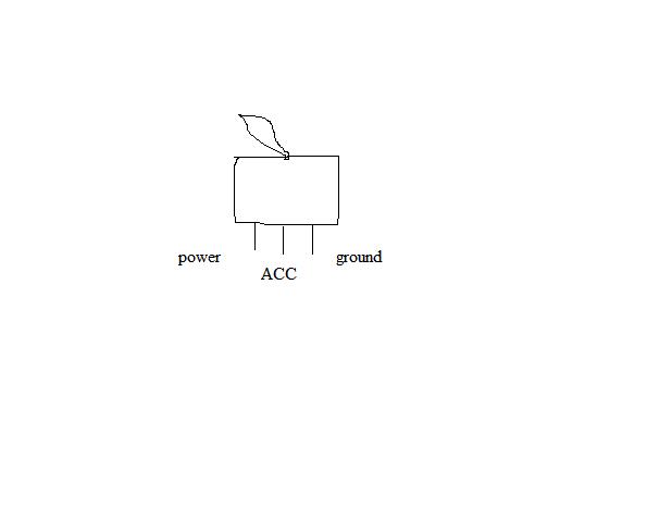

Ok so basically the the picture will show you everything.
Since i do not know alot about electronics, i am wondering how do i set this up.
It is a lighted switch that has a LED in the switch so it lights up when the circuit is on.
Electrical wiring
- the switch, self explanatory.
- SWITCH.JPG (8.09 KiB) Viewed 4281 times

Connect the +V power source to the POWER lug, probably 12VDC, and the -V of the power source to the GROUND lug.
Connect whatever you are powering ie. mix fan, to the ACC lug and the GROUND lug.
What you are doing in the switch is switching the power that is present on the POWER lug to the ACC lug and also an LED in the handle. The GROUND is there only to allow a full electrical path for the LED in the handle, otherwise its connecction on the switch would be unnecessary.

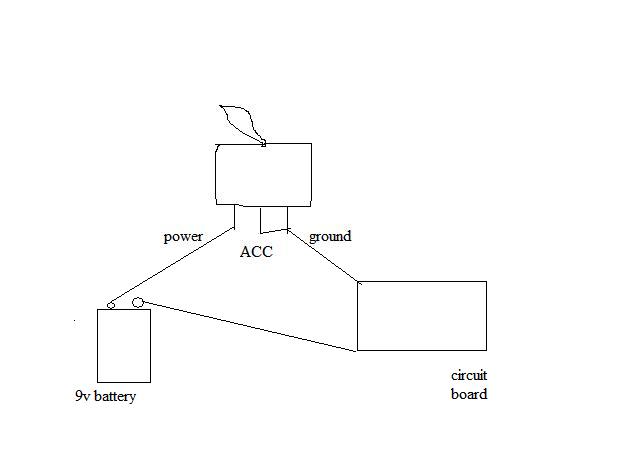

Well, what this switch is for is a safety switch for my tazer circuit board.
I just want it to have a LED (which it has in the switch) so that i know when its on.
Im not sure i understand exactly what you are saying starman.
Is this what you are trying to say?
If this is wrong, can someone just modify my picture because a pictures worth a thousand words
If this is correct, would the switch still light up.

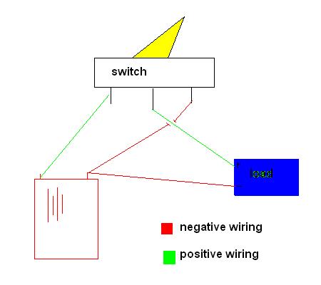

I am pretty sure that will work... if not, connect the ACC directly to the circuit board, and the ground and circuit board to the negative terminal... ill give you a pic of how i have my led switch for my chamber fan set up, it works on the same principal...
- switch.JPG (14.21 KiB) Viewed 4215 times
"<I>For dare to be peace, I have to keep at it everyday, da Man doesn't take days off so neither can I</I>" -<B>Bob Marley</B>, day before a performance, a day after being shot in the chest. "<I>If you are the big, big tree, we are the small axe, ready to cut you down!</I>" -Bob again :brave:

What Starman said sounded aboot right, you may want to play with the terminals and a battery just to make sure.
soldering the neg to the ground is just completing a circuit to nothing. all it's doing is connecting the battery terminals to themselves when ur not using it (off position). a waste of electricity. leave the ground terminal empty unless u want to use it as a second ACC.
WHY PAY FOR IT WHEN U CAN MAKE IT?
Wow, im stupid
I didnt think of using something so simple at a 9v battery. Wow, im sorry i even posted this topic.
Turns out that all you need to do is connect the power and the ground, no need for the ACC. But it still serves a purpose.

It's not there for nothing. It's required to provide a ground return for the LED to light. If you don't care about the LED, you can ignore the ground connection. The "waste of electricity" comment is nonsense...where do you get that idea?i-will wrote:soldering the neg to the ground is just completing a circuit to nothing. all it's doing is connecting the battery terminals to themselves when ur not using it (off position). a waste of electricity. leave the ground terminal empty unless u want to use it as a second ACC.
Dax's drawing is correct.
The LED doesnt light without the ground though, so in this case i guess you do need it.

NOOOOO, not true....LikimysCrotchus5 wrote:Wow, im stupid![]()
Starman is right, i just tried it.
Thx for all your advice.
