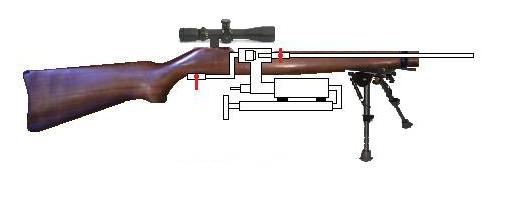

Hey guys,
i'm starting to get back into the spud gunning :roll:
My plans are to build a Pneumatic inside of a Sterling rifle stock.
I want it to be all metal, now here comes the questions:
Does the paint design show any flaws? I've never made a piston, but theres always a first time for everything, not sure what size galvanised T it will go in, but any recomendations for material for the piston + face?
The chamber will be about 10-15cm long, about 1 1/2" wide galvanised steel.
Ill be running it of those C02 tire inflators, and ill have a shock pump mounted onto the bottem for the extra high power shots.
The barrel will be 10mm Aluminum and not sure how long.
***EDIT***:
do these canisters work in those c02 tire inflators? they are like cream chargers or something i think they are n2o
Here's the design:

if you want to use 10mm barrel then a 3/4" qev would be an overkill... a 1/2" wil be just fine... however you might consier getting a 15mm barrel becasue it will be easier to find ammo for it... if you do so then it would be good to have a 3/4" QEV...
generally I advise you to buy the larger one.. the difference in price is not that big and you can use it latter for your next gun or use larger barrels for this one etc.

mcmaster has them and I think they ship them abroad... but I think that it will be cheaper for you to buy them locally... either use google or ask MrCrowley and some other members from aus - I am sure they will help you
al-xg has used his QEV at ~800 psi... I use mine at 400 - 450 psi without any problems.... (NOTE I am talking about 'european' QEVs - I'll post a pic of it later I got to go)
seriously consider switching to larger barrel and a 3/4" QEV - you'll get more power for a few $ more.. plus it will be much easier to find ammo for it... (I am sure that other members will tell you exactly the same)

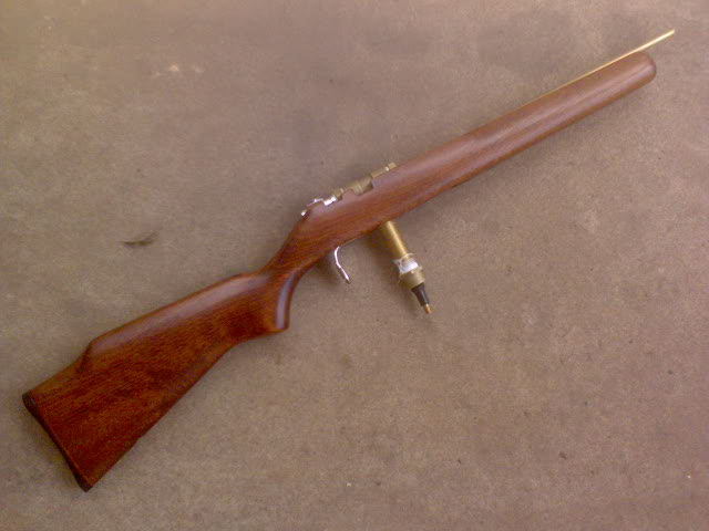

Hey, I hope experament_u2 doesn't mine me using this.
Id say that you wont need a chamber as big as you specified, and a 20mm brass Tee should suffice, use brass instead of galvanized steel as brass fittings have much nicer threads then gal (but are more expensive)
As a piston, use a rubber cork as they create a 'perfect' seal and don't break, (well not for me)
This is experiments gun that he made a while ago.

Hey pyro ninja
Yeh money is not that big of a problem.
So ill go for brass, and that picture is almost exact to what i want, except ill have a small chamber going under like in my paint drawing.
I Wont this to be VERY powerful.
What type of trigger did experament_u2 use in that cannon?
