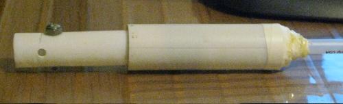

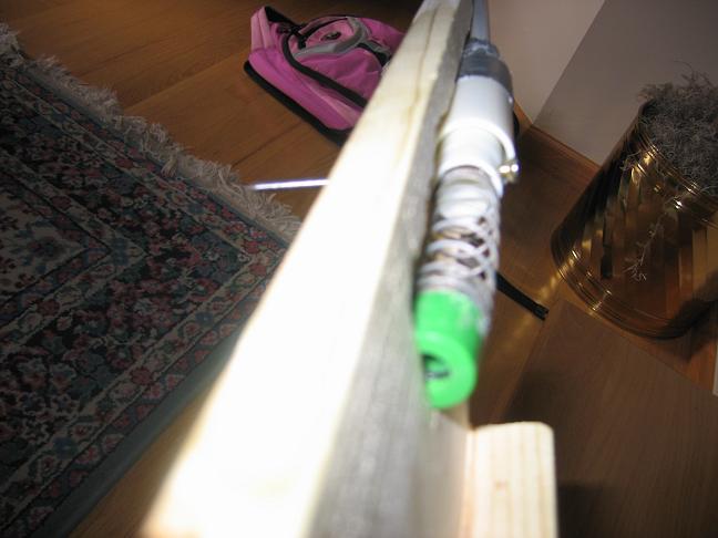

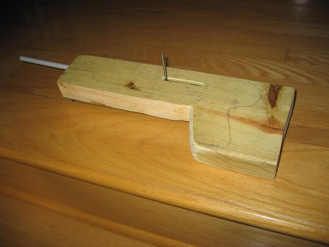

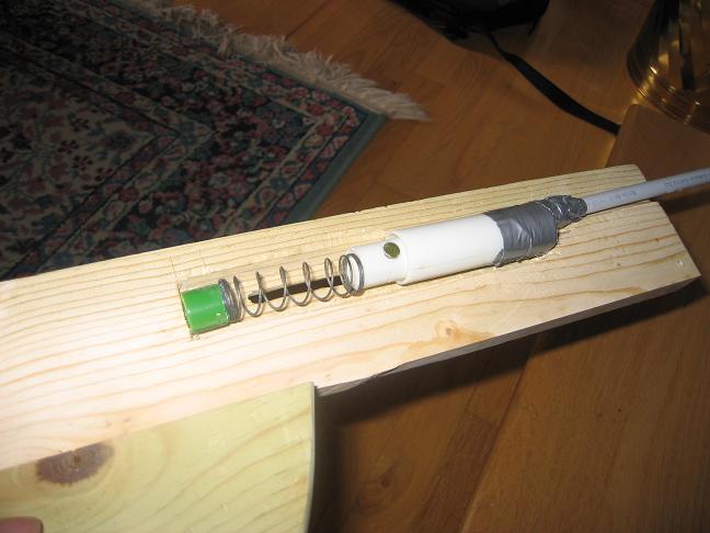

I wanted to make a gun that doesn't run off the air compressor so i was looking to try and make something like one of ant's designs with the ball bearing in a cap but i don't have the supplies yet so i went and made a spring airsoft gun.
My first attempt worked but without triggering system so you held the lever back and let go to shoot .
Im starting my second attempt using 3 tubes to allow for lever to return to original position, and allow for easier reliable reloading system.
Spring Airsoft gun
- first attempt

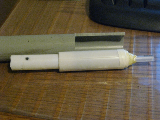

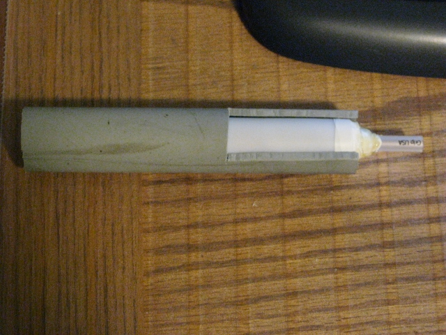

- 2nd attempt 3 tubes
- Tubes 001.jpg (18.76 KiB) Viewed 4778 times

The point of three tubes are...
1 Outer Tube - Where the piston is kept in place andh elps with it gliding
2 Middle Tube - Is the thing that pulls the O-Ring'd piston back
3. Inner tube - The piston that creates a burst of air to push the bb out.
My designs abit different from yours but the good thing is that after you cock the gun the "lever" goes back into place.
the middle tube has a tube where it pushes and loads one bb like in a commercial springer, except my magazine won't be in the handle of the gun.
