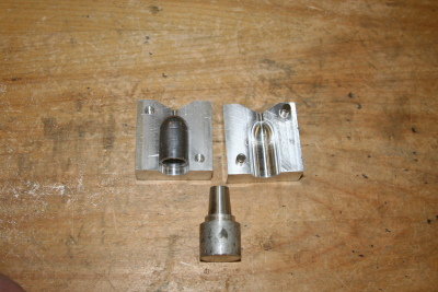

For "spudding" type slugs, I have to agree with Jack, the foster slug is the way to go.
The molds can be as simple or complex as your tooling allows.

The mold is alli right? What else could i use?, how many slugs can i cast in lets say one hour? How much lead is needed for 100slugs?
- Gippeto
- First Sergeant 3
- Posts: 2506
- Has thanked: 2 times
- Been thanked: 17 times
Yes, it is aluminum.
"Way back in the day", bullet molds were cast from iron. Smoking the mold with a match was the method of providing a "release coating".
If you use a cold steel bar, the lead might not bond to it, but I've not tried that so I cannot say for sure.
I would stick with aluminum.
Speed of casting is dependant on too many variables to get a round/hr rate that is accurate. That mold gets pretty hot. (To the point where leather welding gloves start to smoke.)
That slows me down.
How big are your slugs? The one in that mold is 830grain (53.9g). There are 7000 grains to the pound, or 15400 grains to the kg.
100 X 53.9g =5390g
That's roughly 2 1/2 pounds of lead casted.
That slows me down.
100 X 53.9g =5390g
