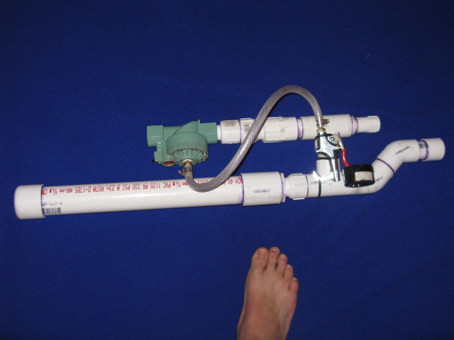

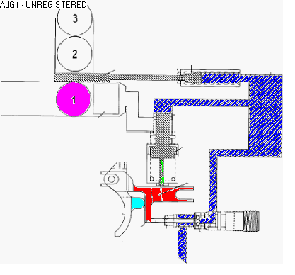

Ok, I just got this idea into my head today. I was thinking about both a paintball barrel and a way to use the exhaust of my gun & I came up with this crazy idea. Basically, a hose is connected to the exhaust, which goes to a small piston (bolt?) behind a gravity magazine. When the gun is fired, the bolt prevents another paintball from falling into the barrel.
My gun. (and to satisfy JSR's festish...)
This is what I am thinking.

but yes, good idea, in some ways similar to the blow forward bolt but using exhaust gas that would otherwise be wasted, ingenious. I see no reason why it shouldn't work well with a bit of work.

similar to this. fixed it

Not too obvious at first :P
But that also uses an air blast while firing to close off the magazine. It doesn't use pilot gas because that one uses a trigger that physically holds back the pressure til right back, it uses the main air blast as it goes along to the pb.
