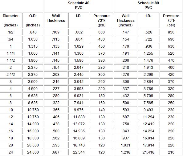

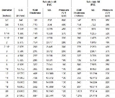

Depends on the diameter and SCH rating.
This should help you:
http://www.pvcplus.com/PVC%20schedule_40_&_80_pipe.htm
Though most people rarely go above 180PSI with PVC, even if the rating is a few hundred PSI. If you're going over 200PSI, i'd recommend metal components.
