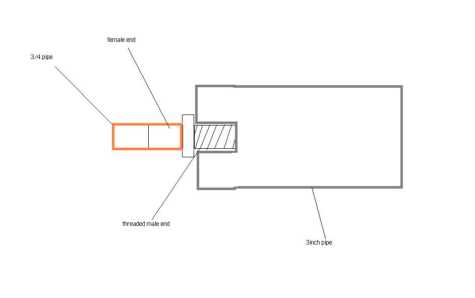

epoxy could work but there are also fittings that go on the copper via solder and then on the male end there are threads then all you have to do is find the fitting that fits the threads looks like this

Just to make sure we all understand each other, I'm talking about a ½" barrel going through the whole 3" air chamber and getting out the front and rear ends. I will drill a hole in each cap so the barrel can go through. The drawing isn't exactly what I meant... The pipes won't be threaded.
