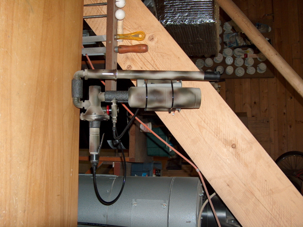

We put this together as a little beer drinking project at work. It uses a propane cylinder as the chamber.
The valve was removed, the tank filled with water, and then the valve area was drilled and tapped for 1/4"npt.
The "canon" has onboard charging via 12v compressor and a 3cell 1650mah Li-po battery. It is generaly charged to 100psi, and will get about 30 shots per battery charge.
It works like a charm.

You MUST elaborate! Do you have any videos of its operation? If it does what I think it does that would be a perfect addition at my fraternity house.Gippeto wrote:We put this together as a little beer drinking project at work.
Cheers! 8)

What do you "think it does"?
It shoots marshmallows mainly, and occasionally more "damaging" things, such as pieces of hickory.
