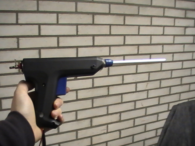

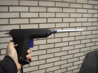

i made this little mini in about 7 hours
it uses a glue gun as housing
and the glue-heating chamber as combustion chamber

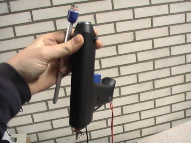

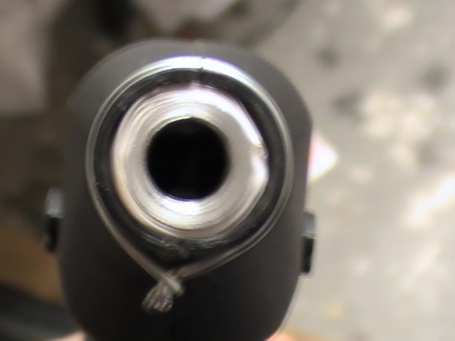

it has a detatchable barrel, made from the detatchable glue nozzle
it uses a flyback transformer running on 5 watt for ignition
sorry for any bad grammar, i am dutch and 13 years old
just some test firing

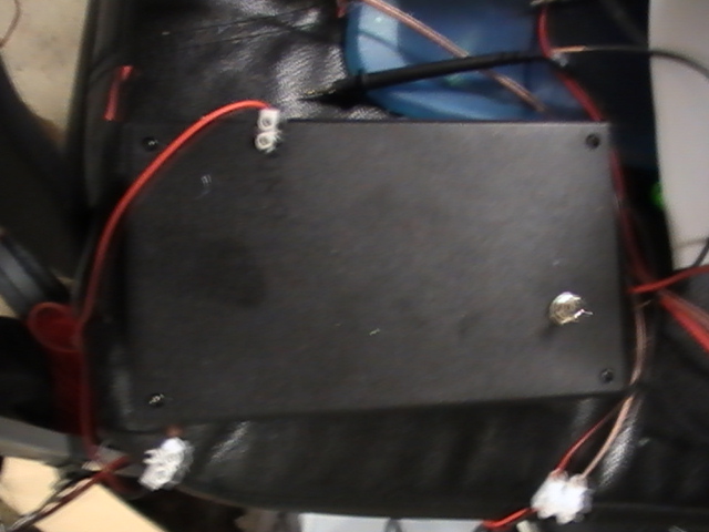

for remote firing<br />&amp;quot;The Black Box&amp;quot;10000 v power supply<br />housing the flyback
for remote firing
&quot;The Black Box&quot;10000 v power supply
housing the flyback

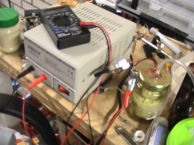

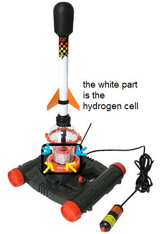

electrolyser
electrolyser
with barrel detatched
the assembled gun
the assembled gun

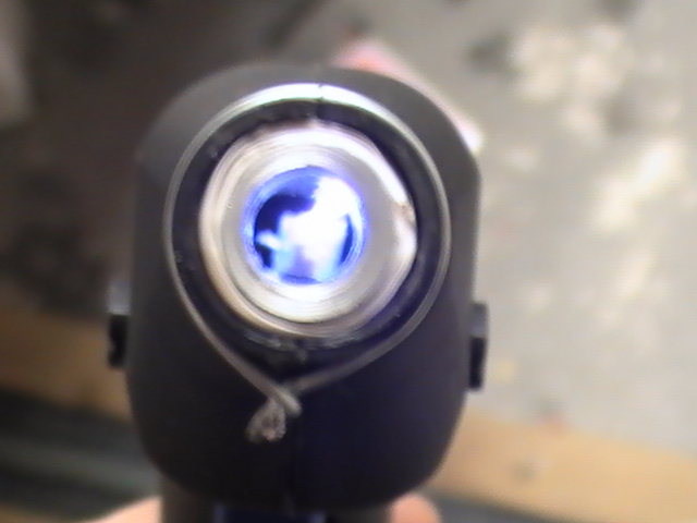

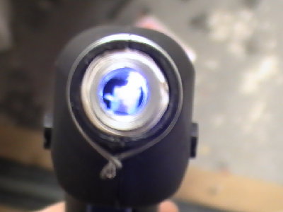

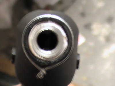

with spark
with spark
without spark
without spark

very professional looking mini.
Hows the power with H2?

for short barrel designs it's i think the highest of all gasses
it can shoot a q-tip through 2 sheets of paper(i consider that high)

its pretty cool how you do your own electrolysis and i like the look of the gun too, and the spark isn't bad either :wink:
Impressive, I like how you managed to fit it the glue gun case, you really out to use a piezo ignitor to make it portable. What sort of penetration do you get with "serious" projectiles like BBs or airgun pellets?

i haven't tried any "serious" projectiles, because at the moment i don't have a fitting barrel
i'll work on it
i know the power of pure H2 and O2 mixed in the good proportion, so i used the flyback for remote firing
but now it's tested maybe i can put a piezo in it, but for multiple shots, i would have to have a H2-O2 storage tank

ok so i made a new, longer barrel, fixed some chamber air leaks
and ordered some .22 airgun pellets
i measured the barrel at roughly 5.7 milimeters
so they should fit
i will upload some dmg pics when they arrive

could you post details about your Electrolysis machine?
I kinda want to do this.......
alwinovich
Posts: 36
Joined: Wed Dec 17, 2008 1:18 pm
about the cell
it is a electrolyser ripped out of a (€40)estes hydrogen rocket kit
housed in a jam jar
powered by a (€50)10 amp battery charger
where in tap water it draws about 5 amps where it generates 2 cc/s, i add potassium hydroxide(€14/kg) or sodium hydroxide(lye,€4/kg) if i want more amps=faster production
if any1 wants more details/tutorial about the gun/electrolyser/flyback transformer, just ask
Ok, then give me some details on your flyback ignition.
What kind of flyback did you use, and what else?
Maybe any schematics...

rp181
Posts: 1090
iemand, there are many different ways to drive a flyback. From the look of the spark, am i right in saying its 555 driven?
Why do you disconnect the hose every time? Seems it would be more convenient to keep it attached to the syringe, and add a T to the electrolysis machine.
