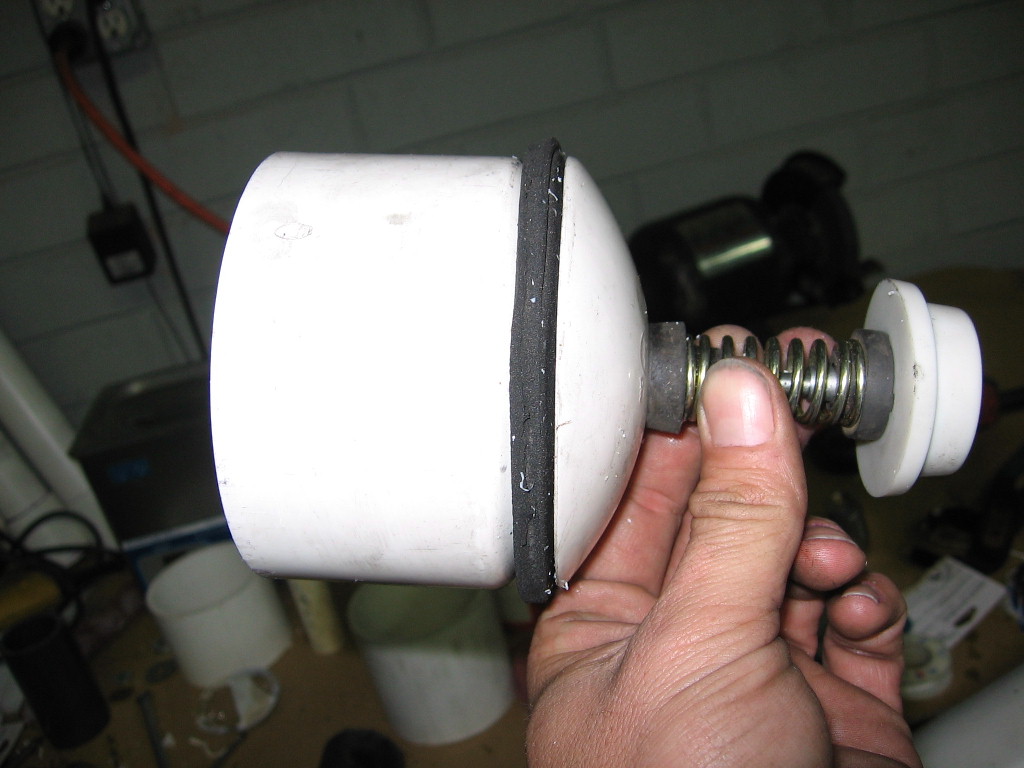

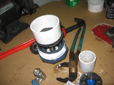

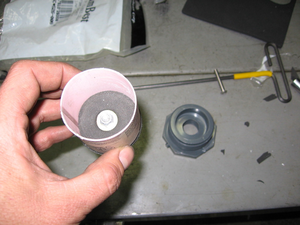

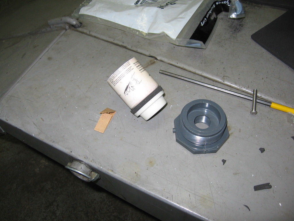

I shave a lot of time in the piston dept. by "inverting" the cup so to speak...(it only works with coaxiels)jackssmirkingrevenge wrote:Using standard parts, perhaps, but sadly I'm of the epoxy mindset, a versatile material but it turns hours of building time into days of waitingjeepkahn wrote:I think you'll see that with proper planning, a couple of hours is all that are needed to build a gun properly...
I'm no good with graphics so I'll try to 'splain it... I take a "cup" so to speak,roughly the inside diameter of the outer pipe, and cut a gasket to fit inside the cup snugly, then I cut another gasket slightly larger(good fit, not too tight) to fit inside the outer pipe, I then drill a hole through the whole lot and use a small washer inside the "cup" to hold the gasket, and the use a large washer(almost as large in diameter as the gasket) on the outer gasket, and then as a bumper I use a 3/4" tall x 1"diameter bumpstop (available in most hardware stores as a doorknob stop). In order, I take a 6mm bolt insert it through 1.smaller washer,2. inner gasket, 3. through the bottom of the cup,4.through the outer gasket, 5. through the larger washer, 6.through the bumpstop. 7.through a washer that fits inside the bumpstop, 8. install the nylock nut and snug it down. I then slide the "piston/cup" into the barrel open end first.
this design allows a much more efficient use of pilot volume and allows the barrel to come almost to the bottom of the "chamber", the effective thickness of the piston is about 3/4" because by putting the open end forward it allows the sides of the "cup" to provide stability without added weight or dead volume... the bumpstop also serves as seal around the pilot to help hold the piston open until all chamber pressure is evacuated. I'll get pics as this one goes together tonite and try to post them tomorrow...

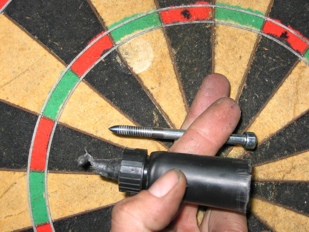

- this pic shows a selfdestructed blowdart, the bolt is identical to the one that is buried to the head in the target, it went through .5" of bristtle,.5" of pressboard, 3/8" of backboard, and 5/8" of plywood wall. you can see where the plastic part bottom out on the face of the board before the bolt pulled through.

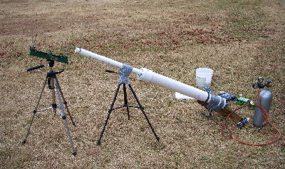

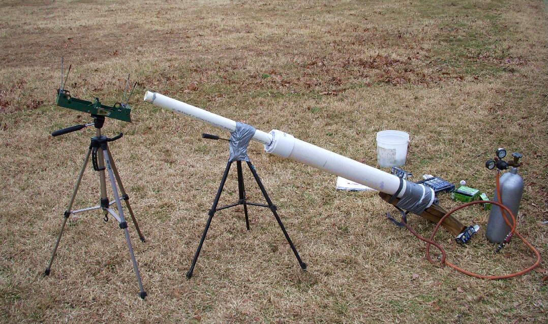

I just built a golf ball cannon similar to yours, and fired it for the first time Sunday.
The gun is a coaxial with a diaphragm valve, using a 3/8" QEV for the pilot. Barrel is 70 inches 1.5" SDR 26 sleeved inside of 2" sch 40. Chamber is 41" 4" sch 40. Powered with CO2.
All shots were at 25 degrees elevation.
10 psi: avg 123 fps, 133 yards
13 psi: avg 170 fps, 187 yards
16 psi: avg 206 fps, 240 yards
18 psi: avg 231 fps, 252 yards
20 psi: avg 253 fps, not enough room to shoot it.
4 shots were taken at each pressure. The distances are where the balls stopped rolling. Temp was 37 F. and the ground was frozen. Distances were measured with a GPS, and velocities with an F1 Chrony.
When it warms up it will be interesting to see how it does at higher pressures. I trust the valve up to about 125 psi

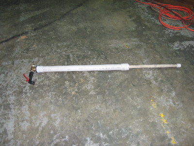

in six hours I built the gb cannon, and the 2 smaller coaxiels, I've test fired all of them(dry) and the only prob with any is that I had to order a 3/4" qev for the gb gun, the garden sprayer works great for the smaller guns, but it doesn't flow enough to pilot a 4"piston ( whoda thunk it? lol), the 2 smaller guns are already with their new owners( they were precommisioned), my qev will be here monday... the gb gun will be more than safe up to 200 psi....jackssmirkingrevenge wrote:jeepkahn wrote:I just overbuilt the pneumatic... It's now 114" barrel x 56" chamber...Couldn't Help myself

How'd you like my blowdart???

the smaller coaxs will seal and fire with 3psi, so I'm fairly happy...
