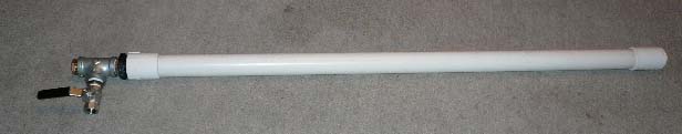

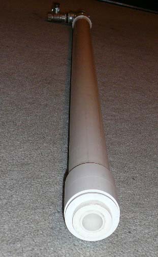

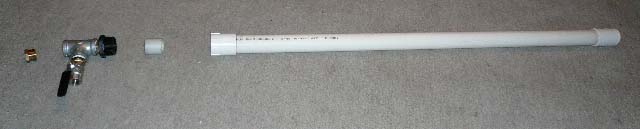

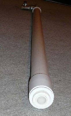

Well, I've never built a pneumatic before but thought I'd give it a go. I've almost finished this one, just need to drill and tap a hole in the plug to fit a schrader valve for filling and attach the rubber to the front of the piston. The piston is made from a 25mm end cap with a 32mm internal sleeve cut and glued to fit a little better. The rest of it should be pretty self explanitory. I look forward to your feedback.

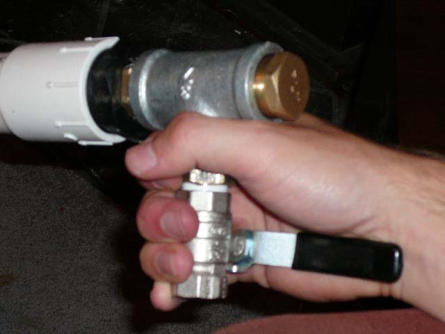

how the trigger is held.  Squeazing forces the handle to the ball valve down.

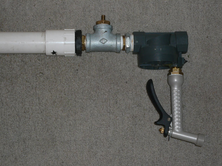

The internals, sort of.
The business end
The business end
Full length is 1200mm (3' 11")

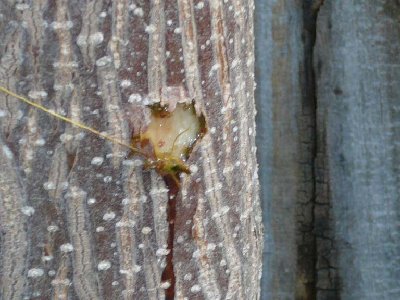

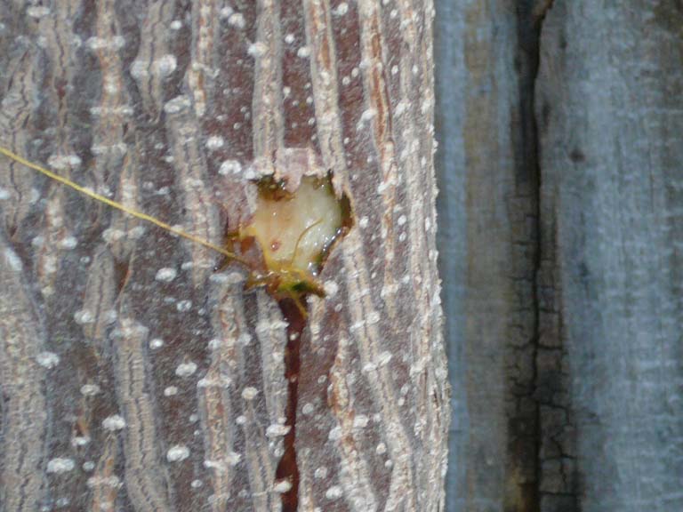

Another target miss, but an impressive mark.

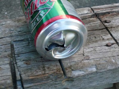

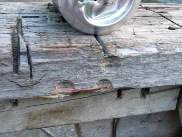

Not all shots hit their mark

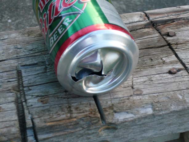

shooting the base of a can of DB Bitters

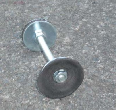

The new more effective and durable piston

Thats a really clean and nice coaxial. That thing isn't going to have any problem shooting through things. I couldnt tell weather or not the piston had rubber on it. if it doesnt it wont seal very well, Im probably wrong, but just thought id point it out. You did a really good job on this.

tater36, these photos are a little old, the cannon was completed and the fill valve(not visible in these photos) is now in the brass end cap seen on the left in the disection pic.

Well I created a new piston out of some high density foam, some washers and an 80mm M6 bolt. The results are impressive, to me at least. I posted some damage pics which can be seen at the top of the page, sorry couldn't figure out how to set the order the pics show up in. Ammo is 16mm glass marbles and shots are all at 100psi.
