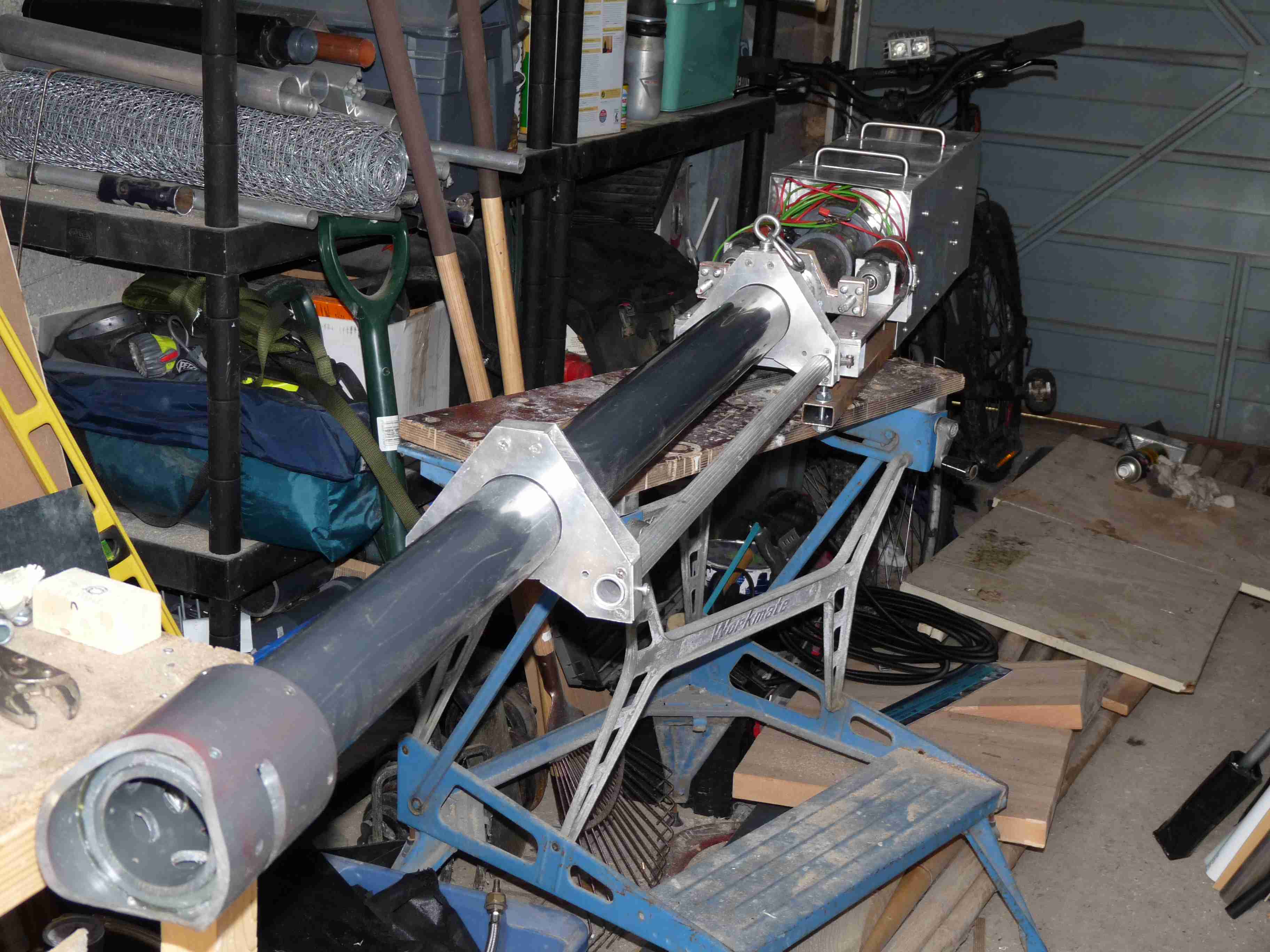

This is a hybrid cannon designed for automated fire at a 2x mix. I wasn't after a super powerful hybrid, just for something with a bit more punch than a standard combustion, what I really wanted to have a crack at was using burst disk cartridges.
The chamber and barrel are both made from 16 BAR PVC. There has been much debate on this forum about the use of PVC in hybrids, after digesting the bulk of it I decided this PVC would be sufficient, with precautions. So the chamber is completely sleeved in couplers giving a combined wall thickness of 12mm, this is set in an aluminium framework with galvanised steel sheet bolted around it to contain any shrapnel should the chamber fail, and it looks cool. The barrel and chamber are also held together in a rigid aluminium framework so the PVC is not bearing any of the weight or under any tension.
This framework is also necessary for the breech to work correctly. The chamber is 50cm of 110mm PVC, the barrel is just under 2m of 75mm PVC for tennis ball calibre.

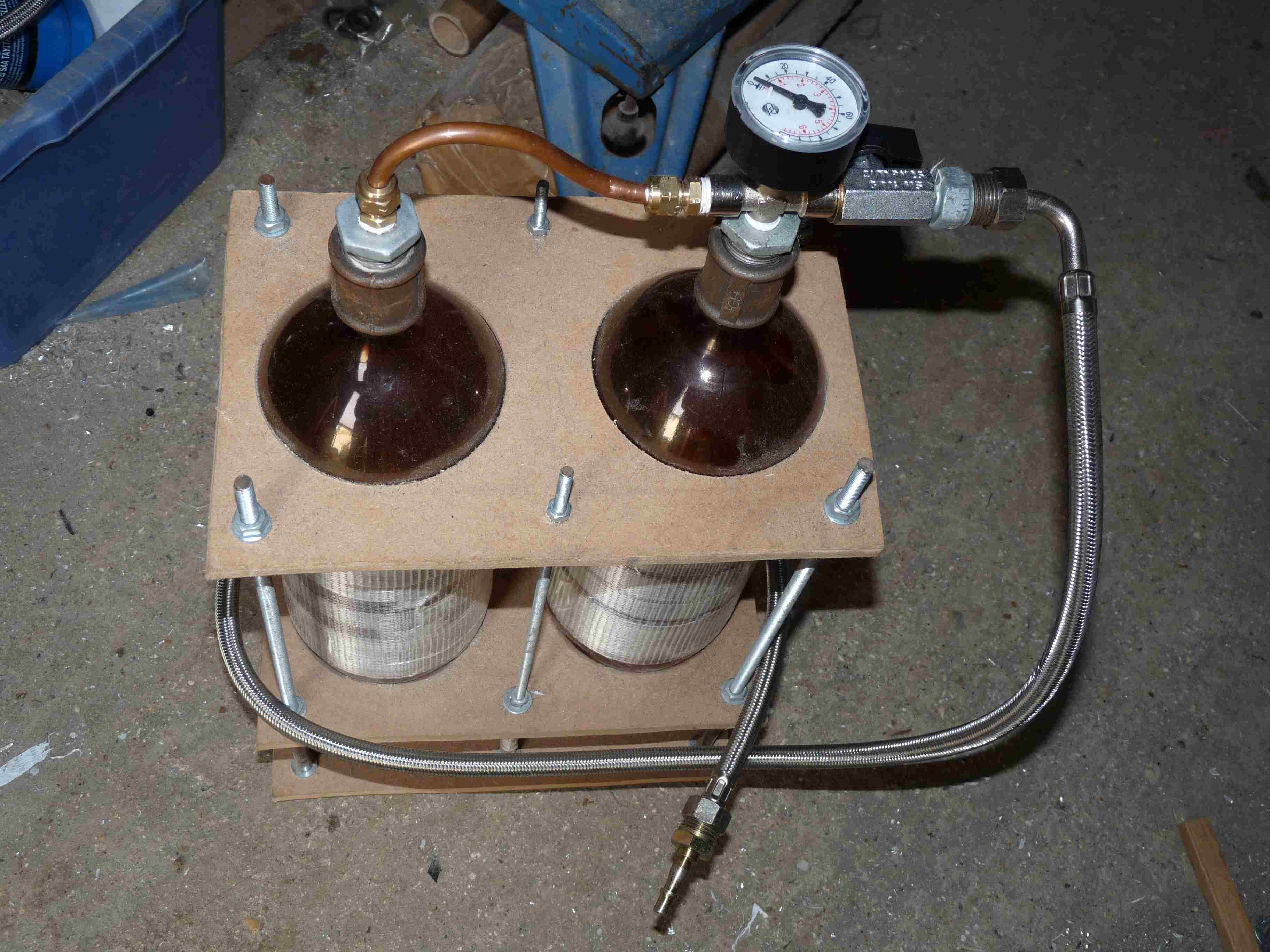

Fuelling was originally going to be using a meter tube for the propane and a 6L tank for air, both regulated. control would be via 3 solenoid valves, one where each ball valve goes on a standard fuelling system. As solenoid valves are kind of expensive to buy I thought I would make my own for a laugh and made a manifold of 3 out of a solid block of aluminium. (If anybody hasn't guessed yet I really like aluminium.)

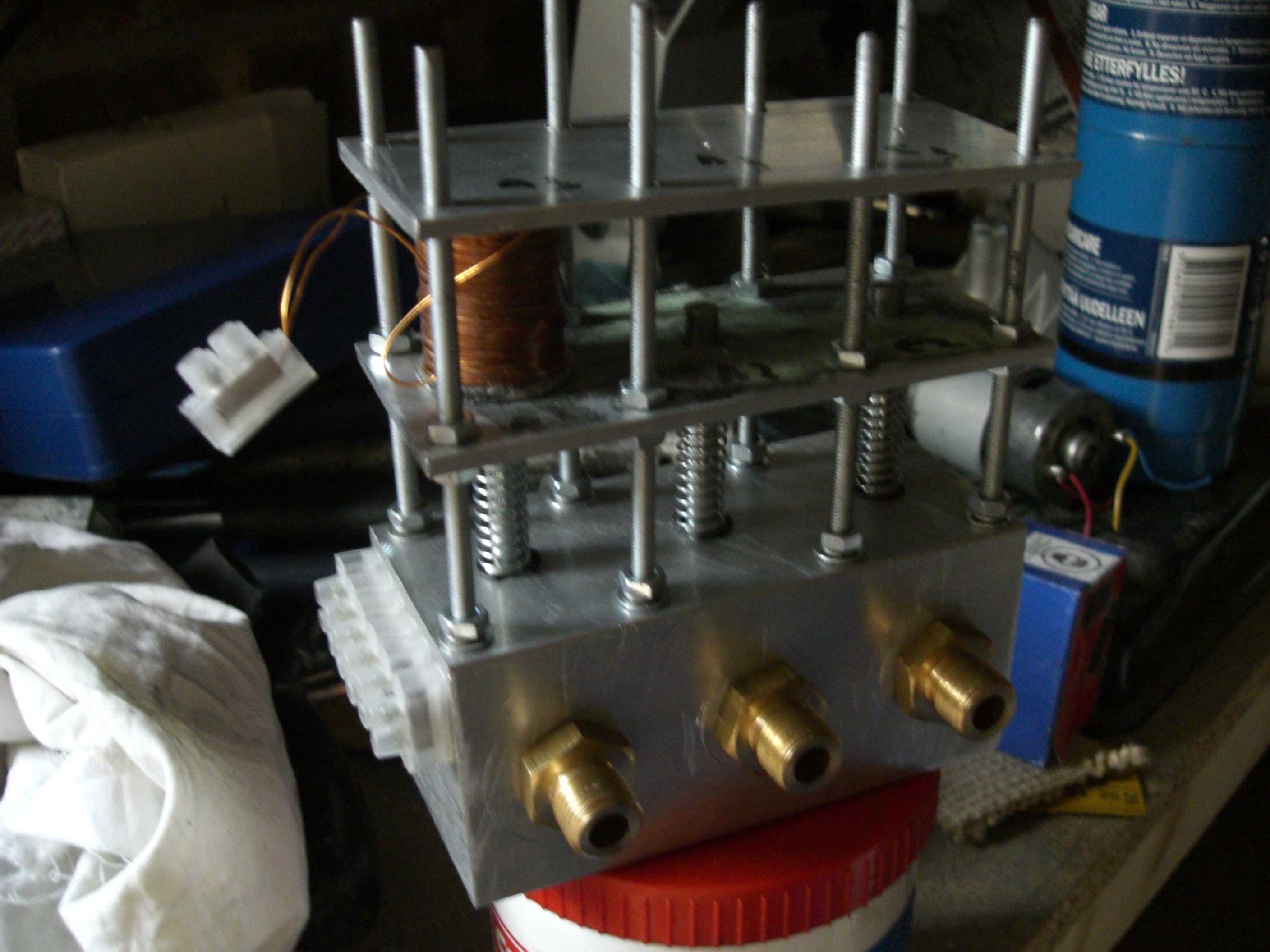

The valve actually worked, but to overcome the friction of my o-ring seals I had to make them really powerful so they get very hot and can't be left on too long. To simplify the fuelling and to avoid having to get 2 regs, I moved to a manometric system, filling the 6L tank with a 5x mix and then feeding this to the chamber via a regulator to set the right x, the solenoid and a check valve.

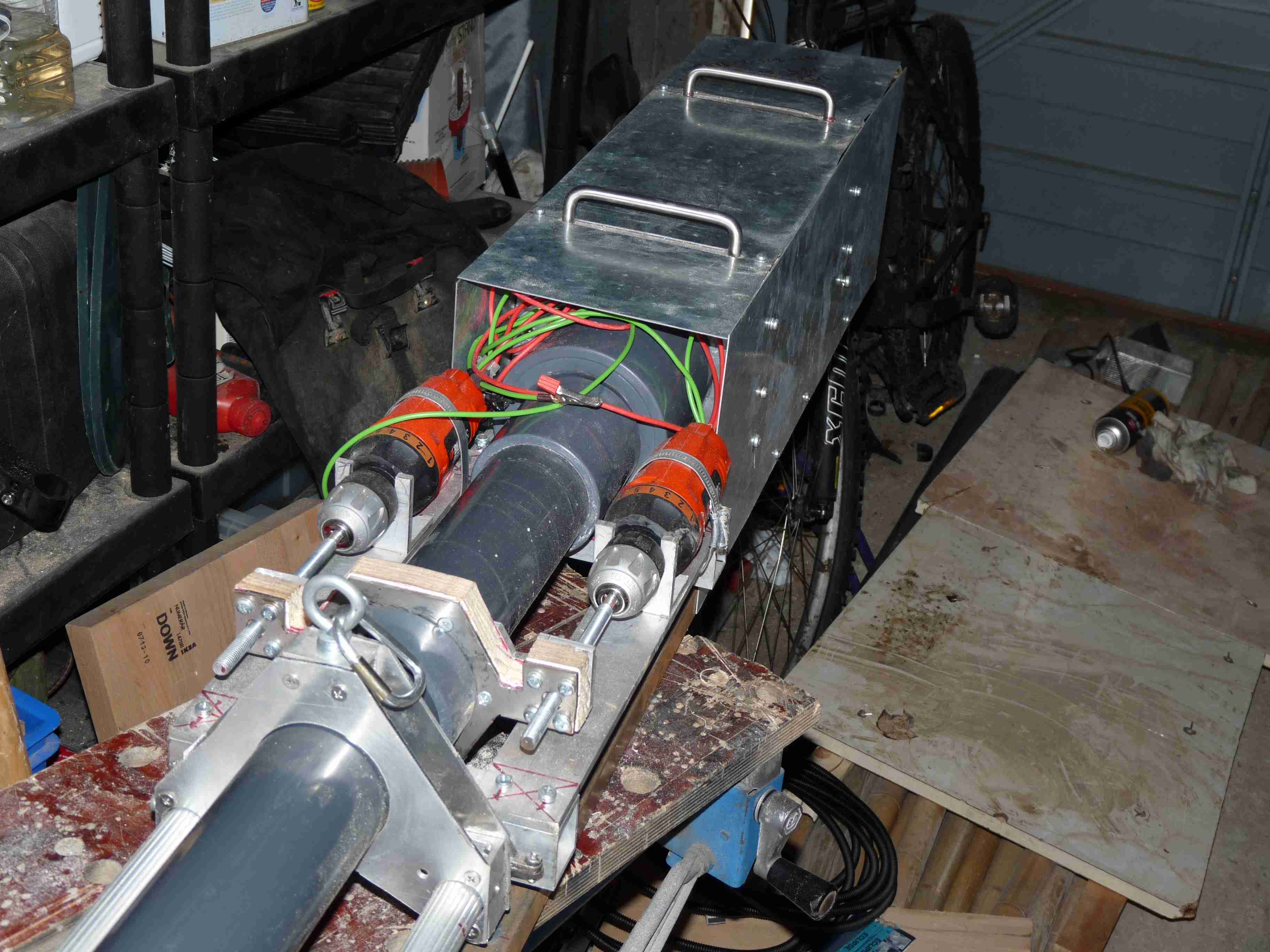

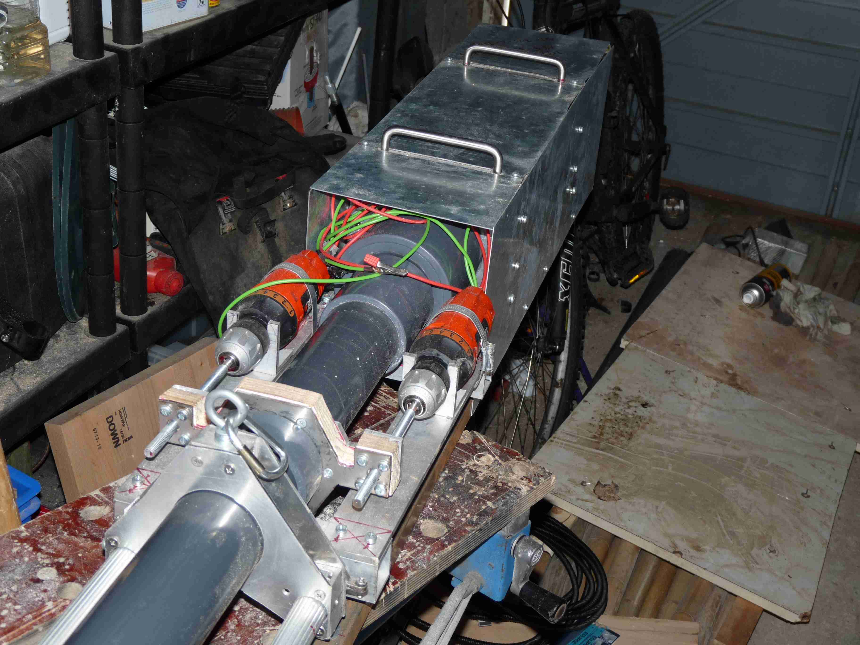

The breech is the complicated bit. In order to get automated fire, a rotary closure like a union would be too complex, a cam lock is a step in the right direction but would again have been too complex. Air rams would simply not have been strong enough to hold the breech closed even during fuelling, let alone firing. What I came up with was using two linear actuators to open and close the breech, consisting of a geared motor attached to a threaded rod. Hobby motors cost a fortune so I used a couple of rechargeable drills bought on the cheap with no batteries or motors. 12V drills, with the crappy switching transistors pulled out and overvolted with a 24V battery produce some serious torque. For threads I used lengths of M10 rod, a wedge had to be ground into the bases to prevent them being pulled out of the drill chucks. I could have removed the drill chuck and case but the torque settings on the drills were very useful, preventing the gun from pulling itself apart when the breech was closed. The combined set-up is very powerful, I had to use some additional steel box on the cannon to prevent the chamber from bending away from the barrel when the breech was closed and pressurised. With a very strong burst disk I have successfully pressurised the chamber to 150 PSI with only minimal leakage, at this pressure there is some serious force on a 3" burst disk! I have no doubt if you accidentally cought your hand in the breech when closing, it would snap your fingers like matchsticks.
The cartridges have a burst disk sealed onto the face using flexible silicone. The cartridge is dropped into the breech, the motors pull the barrel in and the cartridge is sealed between the breech and barrel, both of which have O-rings on the ends.
The magazine has not been finished yet, but will hold 5 gravity fed cartridges. Feeding will be controlled by one or two solenoids in the magazine. Another motor will be fitted under the chamber to extract fired cartridges, which will drop out of the bottom of the breech.

2. Two motors open breech
3. Third motor ejects spent cartridge
4. Solenoid valve opens, purging chamber with fresh fuel mix
5. Magazine solenoids actuate dropping next round into breech
6. Breech is closed, ejector retracts

Really good work here spudamine! I still can't believe you wound your own solenoids, but I applaud your inventiveness...
I like your aluminum framework and sheet metal "chamber guard" although in the event of DDT catastrophe (highly unlikely at 2X), it would just become another missile.

Haha the cider bottle fuel containers are quality
i bet you hated having to drink it all

@ Starman, Thanks winding solenoids was really a pain, the first one was interesting the rest were a bit of a chore, although I improved the design by coating each layer in thermal epoxy as I went along. Not pictured there ia also a piece of malleable iron pipe which fits over the coil and really increases the power.
I hope not to have to see how useful the chamber guard is, the theory is any blast wave will be diverted out of the unshielded base and the shrapnel will be stopped by the steel sheet, or at least have a significant portion of its energy removed tearing it off.

I would build a shield for the storage tanks, in case the mix in them ignites.

Ah, so that's the premixed reservoir you referred to the other day. If you don't want to build a shield perhaps just a long line so it's at a safer distance if it does go.

Awesome, love the homegrown solenoids

I think the fuel tank is ok as is, I don't particularly want it to go off but if it does it will just make a very loud bang, and I'll have to do some more drinking. I never get that close to the thing ayway, firing is done remotely on the other end of a 20m command cable. I rather like the muzzle brake, that's one of the better things I have found with using PVC, you can make things like that quite easily, although I'm not sure if it will do sod all.
With the coil winding the actual winding part isn't that bad, I used quite thick wire so there's only about 300 turns and made a small hand winding jig. The problem I had was getting the gap down the middle the right size, I used a piece of the actuator as the spindle and wrapped it in PTFE tape to give a bit of clearance and get it out without the epoxy sticking it in. It's also quite hard to stop the ends sliding out and making the coil longer.

The homemade solenoid is the most awesome part. Couldnt you make it smaller? (less friction)

Those solenoids seem to be really getting people going
They are far to big, the size was determined by several factors, the smallest O- rings I had, having a 1/4" (6.3mm) drill bit for boring out the holes which were a good fit for my 6mm bar material, and the next smallest stock size of Ali was slightly too small.
On the upside It made quite a novel valve with really good flow for a direct acting valve, although it only works within a narrow operating pressure band for a given spring setting. The spring force balances the pressure and the solenoid is just enough to tip the balance and open it.
