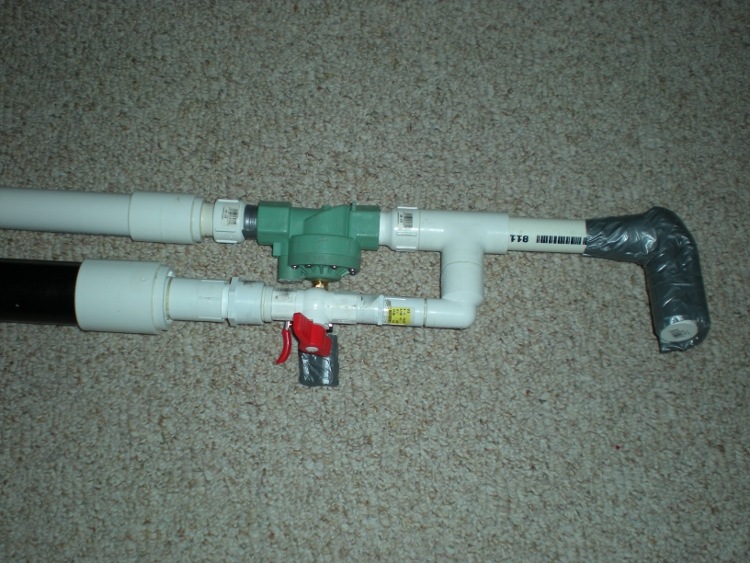

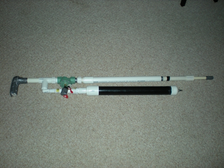

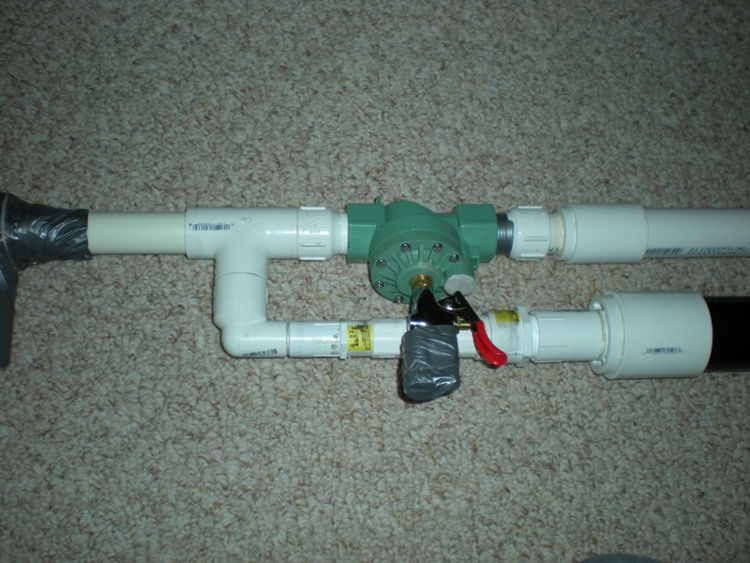

Hey everyone, this is my second cannon and it is awesome. It uses a modified sprinkler valve as the main valve and is a repeater. I can get about 3 powerful shots every time I pump it up. I messed up my first barrel and couldn't go to home depot to get another, so I put a 3/4" cpvc pipe in a 1" pvc pipe and put the 1" in a 1 1/4 pipe that had the right adapter.
The air reservoir is 2" ABS about 2 feet long and the barrel is 40 inches of 3/4" cpvc. The reservoir is connected to the firing chamber by a 1/2 inch valve that is opened a small amount so it lets in air slow enough that it doesn't all fire in one pull of the trigger. Here is a video of me firing it, with damage!!! Yay!

Good for you second gun, just a couple things you may want to change
-ABS Chamber, never use ABS plastic for a pneumatic
-Duct Tape Handel, Looks bad
-Barrel Support, looks like it could use a barrel support
Other than that good gun
That is all.

Me and my friend made one almost identical to that but with a 1/2 ball valve instead of the SV and a tank twice as long, 1/2" barrel and a break barrel breech load for nerf darts. We got about 6 shots off one fill so it was pretty good for only 30 bucks. Nice job, makes me want to build one similar again, you should paint it. 4/5!
Oh and things to improve,
the chamber
support
add a breech loader
and I would also change the duct tape or at least cover it with some felt or something.
the chamber
support
add a breech loader

I don't think ABS is rated high but it does have good fail characteristics.

ABS isnt made for pressure, just cause you took it that high doesnt mean it wont blow up next time, also never mix ABS pipe and PVC fittings If you want stock padding Id use pipe insulation, It looks better
