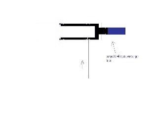

So since the only little portable regs are for co2, I was wondering, would it be possible to build a regulator yourself? provided you had no allotted time period, just with tinkering and trial and error,
If this is possible, great. If not, be nice, I really have NO idea how in the hell these things work... and any insight would be great!
EDIT I did a bit of research, and think I have a basic idea of what is going on in a regulator, and please anyone tell me if my little diagram is right or no, because it would not be hard to replicate...

Well, in answer to your question, I've been thinking about these things for a while.
Here's a crude diagram of how a regulator could be built relatively easily.
Basically - downstream pressure falls, spring pushes open valve, lets air through until pressure is back up, at which time it closes again. Upstream pressure has no effect on the valve's operation.

remember guys, we're talking 3000 psi here, rag, I love your idea, since the pressure is not acting directly against the piston, so springs are easier to adjust... but I imagine it would need to be galvanized not copper for those pressures, and galvanized T's aren't as well cut as your diagram assumes, unless I were to mill out the inside of the nipples attached, (an intriguing thought actually... I will look into that,)

my mod to rags idea
really crappy animation, i tried but i think u get the picture, (pun not intended, but funny)
not as good as i hoped but my idea is that u fill the back to what pressure u want it to be at
and when the pressure on the left side is the same as on the right it slides back coz of the larger surface area, closing off the inlet ready to be fired. Which slides it open again
and u get the idea

Using air pressure instead of a spring is a good idea indeed. Though "my idea is that u fill the back to what pressure u want it to be at" wont work your way, because of the lower surface area on the back. Maybe keep rag's layout (same surface area's), but with your air-spring.
The air pressure can be adjusted more easily then a spring, and on 3000 psi, you would need one hell of a spring...

sputnick wrote:but I imagine it would need to be galvanized not copper for those pressures
Possibly, but copper is what my "standard collection of part shapes" that I have around covers, so that's what I did it in.
I would recommend using an air spring for it, and indeed, that's what I'll be doing if I get round to building one - the only reason it shows a mechanical spring is that air springs aren't very obvious in a diagram, and I don't like labelling my animations.
