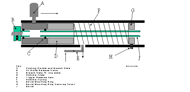

Have you seen the Airforce Stealth? It uses a "transfer sleeve/breech cover" around the barrel which is struck by the hammer (also on the barrel) to open the valve.
This would allow the barrel to remain "fixed" and might lead to improvements in accuracy. (If you're headed that way.)
Opening the breech, cocks the hammer.

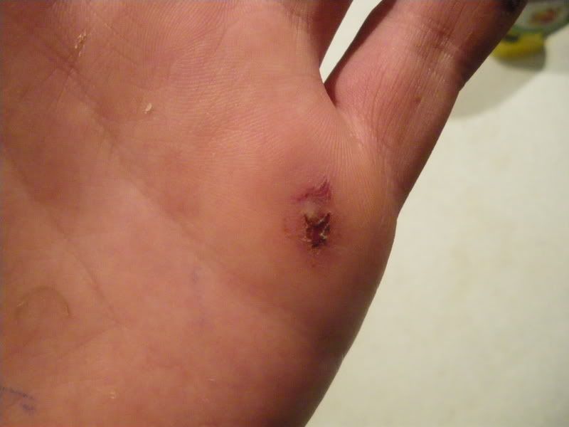

However the sear broke and the launcher proceeded to fire a 0.2g bb into my hand.
Yes.... INTO!! my hand, the gun fired unexpectically and because my hand was infont of the barrel (I know, I was putting another couple of bb's in for a shotgun effect) it embeded the bb into my hand.
My hand was on a 45 degree slant to the barrel which meant that the BB broke through the skin, went in about 4-5mm and travelled up my hand under the skin about 1cm, I quickly rubbed the BB bobble downwards towards the entry hole and managed to get it out, My hand swelled up pretty big.
To get rid of any bactreia, I doused it in some jack daniels and had a couple myself (Maybe some more....... quite a bit more) to sooth the pain, A couple of days later my hand has a good amount of bleeding under the skin but is healing well.
From now on I will b alot more cautious with the muzzle end of my launchers, Even though I am EXTRELMEY cautious, honestly...... If I have to go downrange if the target blows over, I relase all of the pressure in the launcher, place it on the ground pointing the opposite way and go downrange
I have now dismantled the gun but might still re-build it later
Dave
