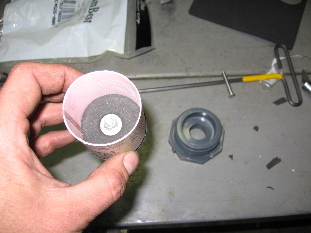

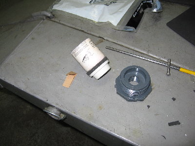

My frustration is growing. I've built at least 5+ pistons ranging from wood to 1 1/4 coupler to pill bottles. So far the pill bottle was the best so far but lacked in strength. All of them work just not to the extent I want. I've seen epoxy pistons and hot glue, but from what I've read both catch. I'm tempted to try a bolt style piston I believe it's called a "toolie", not positive.
So please throw your suggestions at me. Thanks.

Wow, sorry about that typed that in frustration. 2" piston valve Prefer a cylinder. The problems ranged various from to big of equalization, to much drag, and just structurally weak. Spuds my valve is built and it shoots just not to the performance I'd like.

1 1/4 coupling with a 2" washer on each side with rubber+ a smaller washer on the sealing side a bolt running through then a nut to hold it all together. It fits rather loose inside the 2" pipe, sure it actuates but only at very high PSI. I'm not sure if the Lowes I go to has weird 1 1/4 pieces but I've tried numerous ones. I've been pondering other ideas, I'm sure something will come along

If it fits loose, wrap it in duct tape until it fits with some friction and then lubricate. Me and Velocity's first piston valves just used some PVC rod wrapped in duct tape. It's more effective than you think.
Also, when listing specifications for a piston valve, a more helpful list of values would be:
1.) Configuration. If a tee valve give tee size.
2.) Piston diameter (you already said 2").
3.) Seat diameter (what the piston seals against).
4.) Piston construction (you've already provided that).
5.) Exhaust valve and setup.
For you, I'd recommend the duct tape around the piston and a small Q.E.V. for piloting. Just remember to keep your pilot volume down and it'll work fine.

2" Tee
1 1/4 seating
numerous pistons =)
5.) 1" sprinkler valve
2" Tee
1 1/4 seating
numerous pistons =)

Well, it sounds like all you need to do is tighten up the piston in the 2" pipe (duct tape or electrical tape, like I said) and lubricate the piston and it should be working good.
