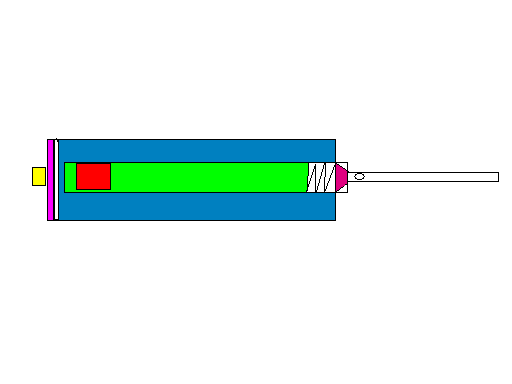

sorry about the crappy paint diagram, but if you're familiar with the post that d-hall referanced you'll get the Idea...
the chamber as I'm figureing will be 3"x24",the green is a 1.5" barrel, the red object would a 4oz perfect seal projectile/compression piston, and the pink would be a reducer to go from 1.5" to 3/4" and the barrel would be sch120 x 3/4" paintball size, there's also a spring to help cushion the impact of the compression piston...
I would imagine that would send a 3.2gm paintball supersonic...

that is pretty much a light gas gun, but without the light gas. It could work, but it would work better if you filled the green area with light gas (helium and hydrogen would be best, and the most available)

And even better if the surrounding chamber gasses are combustible, bonus points for high-mix.ramses wrote:that is pretty much a light gas gun, but without the light gas. It could work, but it would work better if you filled the green area with light gas (helium and hydrogen would be best, and the most available)

the easiest way would be to build a combustion for it...
