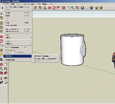

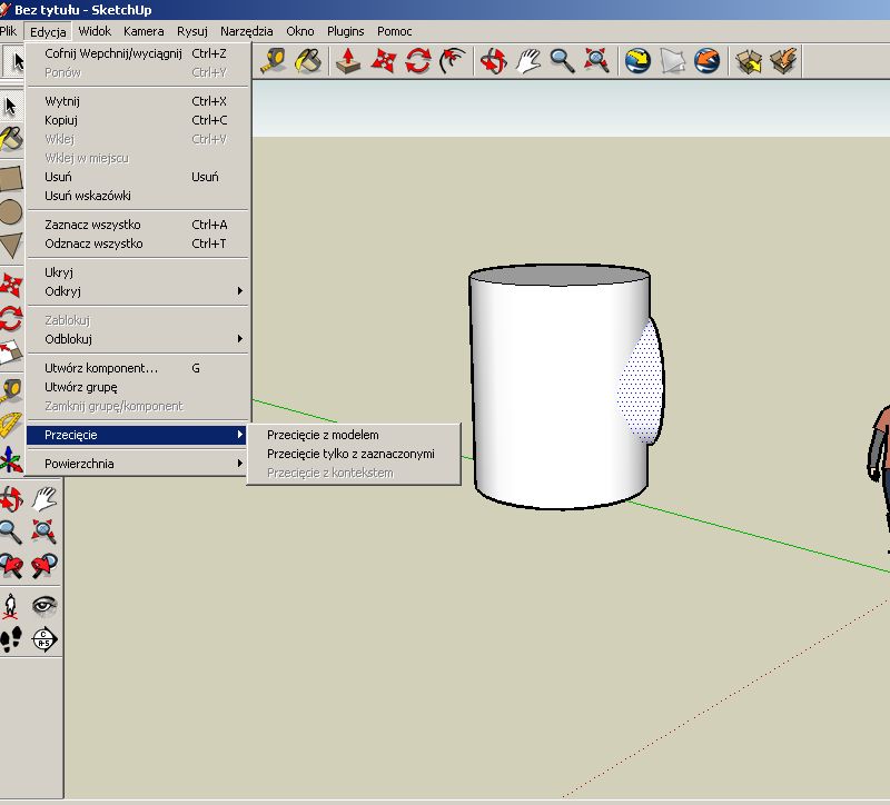

ok now as far as the tool is concerned... as I said I don't know how to switch sketchup to english version (I suppose there is such an option) but I made a screen shot....
it shows what you have to do in order to cut holes on curved surfaces... basically all you have to do is to create an object which you position where you want to cut a hole and then you use the tool selected (in the pic) from the EDIT menu and then you delete the substracting object... if you try this you'll see what I mean
