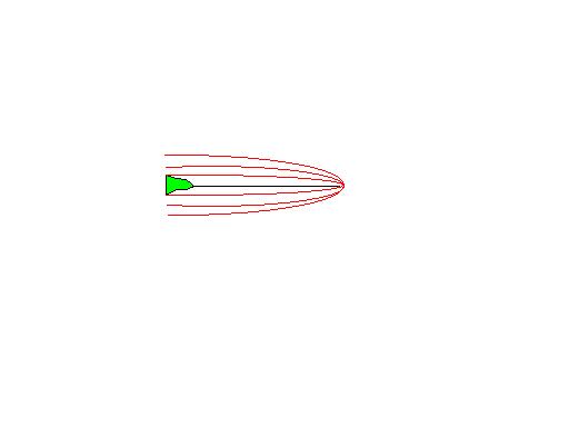

here a BAD drawing of what I was suggesting about "dirty" air...
the red lines represent, albeit badly, the subsonic pressure wave buildup that is "clearing a path" for reduced drag on the tail cone, and yes I realise my elipsoidal lines look more like supersonic shockwaves, but If I've researched correctly, above 800 fps the pressure buildup starts forming and the sears-haack shape plays into drag...

The speed at which transonic effects start occurring very much depends on the shape.but If I've researched correctly, above 800 fps the pressure buildup starts forming and the sears-haack shape plays into drag...
In this case, because the dart is many dozens of times longer than the tip diameter, any pockets of "clean air" created by the tip will close up significantly before the tail unless the velocity is exceptionally high.
Indeed, such a thing could actually be detrimental - these darts are specifically designed to have the drag forces exerted at the tail, not the nose. I've heard no reports from other people of blowgun darts becoming unstable at higher velocities, so I have to suppose there is no significant difference between the drag characteristics of this and a conventional cone shape.
