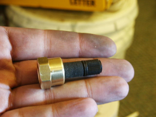

It isn't absolutely necessary to put it through a double layer, it just makes it safer. If you put it through a single layer just make sure it isn't pointing at you. You could just get a shrader valve that threads in. You can usually get them at Lowes.

That really depends on what Lowes you go to. I've personally never seen a threaded schrader valve at any local store around me. I've checked at Ace hardware, Lowes, Home Depot, my local hardware stores... I've looked around the compressors, the plumbing department, around the pumps, around the captive-air water tanks... everywhere, and I've never seen one.lctchamp wrote:It isn't absolutely necessary to put it through a double layer, it just makes it safer. If you put it through a single layer just make sure it isn't pointing at you. You could just get a shrader valve that threads in. You can usually get them at Lowes.
Now, they do sell the metal bolt-in ones at automotive stores. Those do look a little neater, but require almost the same installation process, and don't work any different.
Also, putting it through a double layer of pipe is definitely recommended. If there's a chance it'll pop out (through not likely), why would you want to risk having to re-do the entire chamber just to replace the valve?

I found my local True Value hardware store has them in the air tool accessories section right next to the gauges, manifolds, regulators and quick couplings.lctchamp wrote:It isn't absolutely necessary to put it through a double layer, it just makes it safer. If you put it through a single layer just make sure it isn't pointing at you. You could just get a shrader valve that threads in. You can usually get them at Lowes.
In a pinch you can make one with a tire valve and 1/4 inch pipe cap.

Threaded schrader valves are not going to be found near the pop in schrader valves. They are used in air compressors, so that is the section they can be found.

uhhhhhhhhhhhhhhhh, I have found these threaded schrader valves at both koi (its local) and NAPA auto parts stores. However, I guess you can probobly get one in the compressor section too, it depends where you're looking

just go to ace hardware, the sell threaded schrader valves, all you do is drill a 1/2 inch hole, or 1/4 inch depending on which size you got, and screw the valve in there, works perfectly with no leaks at all, i suggest though putting it where the endcap is joined to the chamber, that way there is more pvc for it to hold on to because its twice as thick
