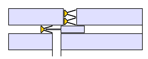

1: you need a place to put in the pellet, either a magazine or a trough to put them in.
2: I am not sure a T bolt system would be the best idea for a pellet sniper, since finding a PVC t is out of the question, and the small metal ones are a little too rough for that kind of use.

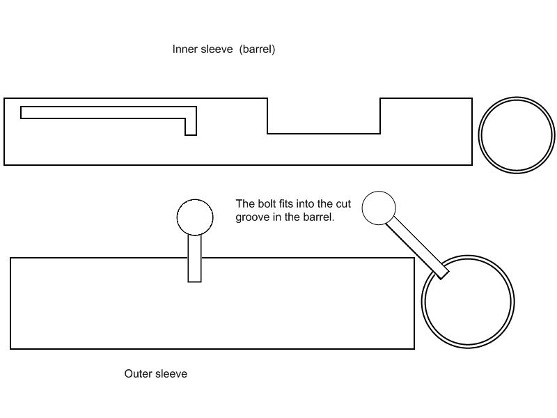

3: I think you're better off with just an inline bolt that is just a barrel with a sliding cover, then find some way to put a bolt handle on that, I will draw my idea in paint, so I'll post that in a few minutes.
- bolt.png (27.72 KiB) Viewed 3469 times

sputnick: 2: I am not sure a T bolt system would be the best idea for a pellet sniper, since finding a PVC t is out of the question, and the small metal ones are a little too rough for that kind of use.
wel I plan using a brass T and a steel piece of pipe since there is no pvc in the gun at al. the advantage of a Tbolt is that you can use a rod as bolt and make the handle on VERY strong and you have no worries about projectiles being blocked.

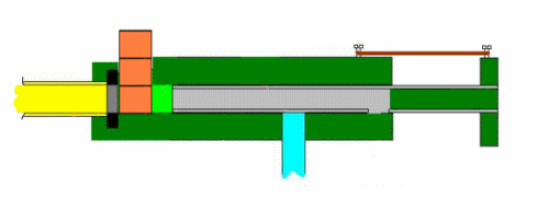

- instead of blowback using your hands for bolt action
- blowback breech.gif (29.37 KiB) Viewed 3440 times
- maybe use this as a basic idea
- pellet_loader.gif (8.99 KiB) Viewed 3440 times
I think spudnicks diagram is a good idea.
It solves the problem of your last pic.
see adding a handle on here is difficult and not that strong

yes in some sort it does but it has more dead volume and is difficult to make a magazine on that
I think I know a way to do it but I need to work it out

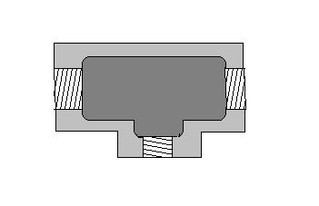

The problem I see with your idea, is that you would need to put some form of guiding rod in to get it through the t, because almost all of the steel ones I have seen look like the diagram attached below on the inside. For the ideas you are proposing, you would need to custom build the magazine anyways, unless you have square pipe fittings
and the T would need to be the perfect size for the pellets, if you put a pellet through one of those (see below) T's, you would never get a decent feed. Forcing air through them is one thing, but keeping a direction sensitive soft metal pellet going through right would be a massive challenge.
And for my diagram above, if you want to add a magazine to it, then put the outer sleeve on the inside, and instead of the trough, put a magazine tube. simple enough.
- galv T.JPG (6.35 KiB) Viewed 3404 times
