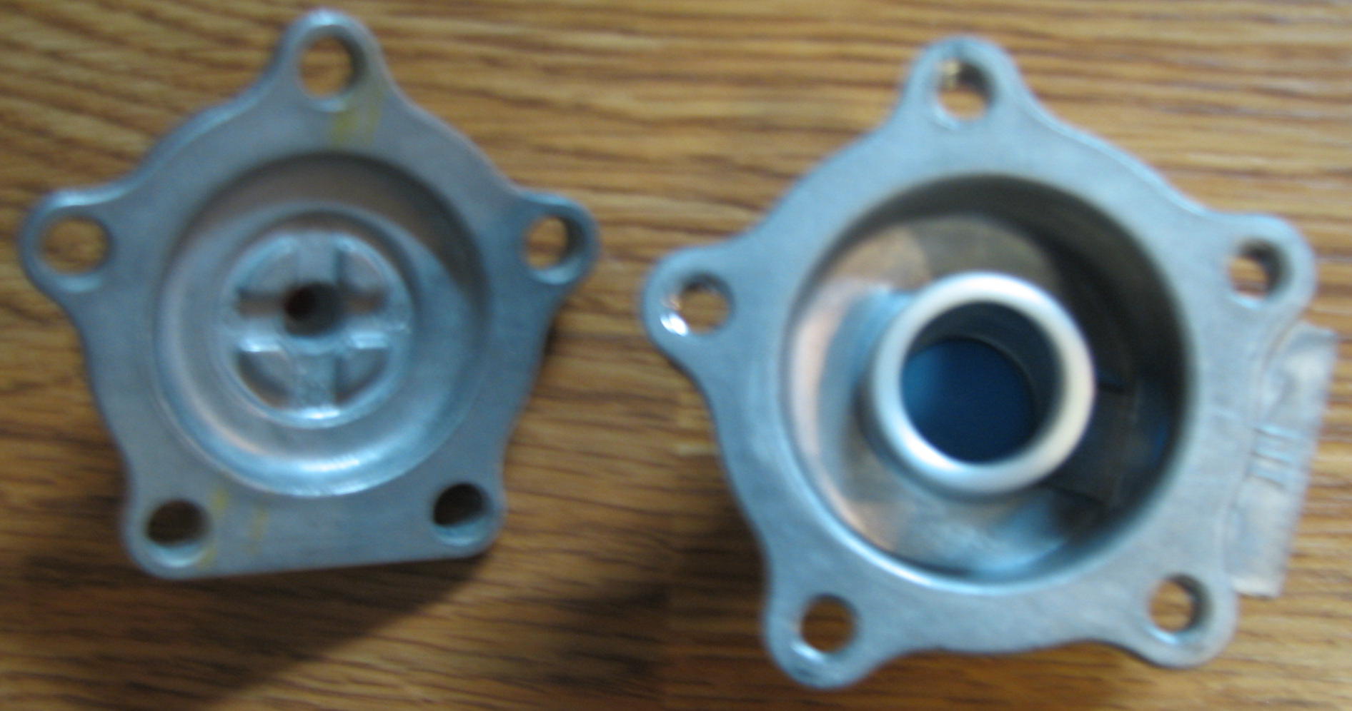

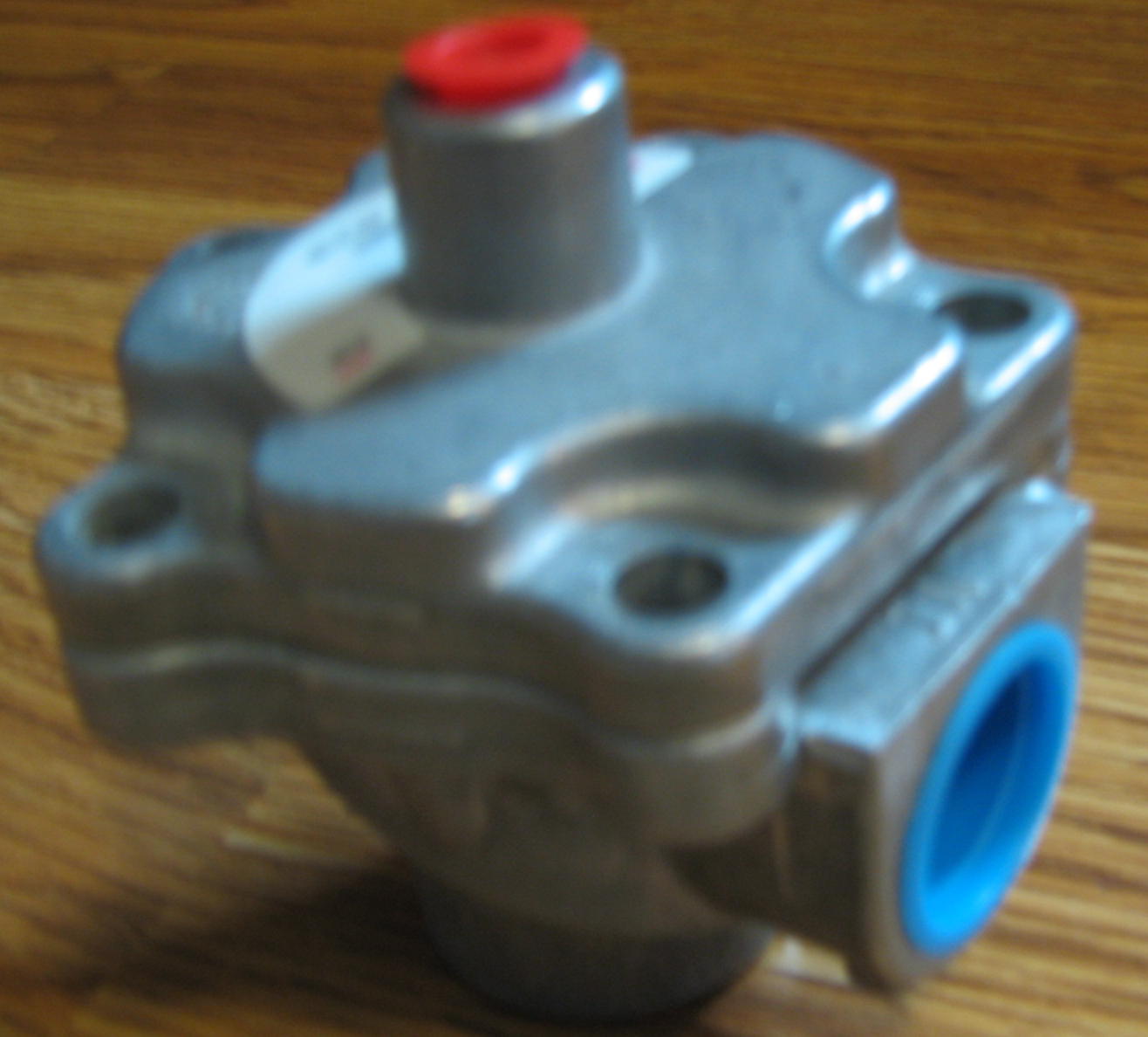

I recently bought a 3/4 QEV off of E-bay. The valve arrived but it didn't have a diaphragm or anything inside. I got a refund and the guy told me to keep the valve. I now have a QEV casing. So basically I was wondering how I could make the diaphragm? Could I just use a rubber gasket and a metal washer? There isn't much room inside, so the diaphragm would have to be quite thin. Any ideas?
Here are some pictures of the valve.

First off, have you tried looking for spare parts? The manufacturer must have replacement pistons.
If not it could be difficult - QEV pistons usually are't just a flat piece of rubber, but are contoured to fit the valve.

This isn;t the piston type.
It might work to just use rubber sheet.The room doesn't matter as the rubber goes inbetween the two parts, with the bolt running through it.

This is correct it is a diaphragm valve not a piston one.
Biopyro wrote:First off, have you tried looking for spare parts? The manufacturer must have replacement pistons.
I know I could order parts I just figured it would be cheaper to make my own.
So do you think a rubber gasket would work?

Trial and error is the way to go. Just find something that you think it works best and try it! Rubber gasket is a good option, btu make sure it is strong enough.

My 1/4" dia QEV has a rubber circle and a thin sleet washer with 6 holes in it (like swiss cheese..) and thats it.
