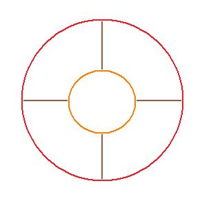

I'm in the middle of making my 1 1/4 coaxail pneumatic and im struggling to mount the barrel in side the chamber were the piston seals because it just flops down. I'm thinking of using sqaure dowl or rolled up tape.
Any suggestions would be greatly appreciated

Are you saying that your barrel is drooping inside the chamber?
If so, just make a small "cross hairs" design... I don't know how to explain it without a picture so just wait like two minutes and I'll add it to my post.
Red=Chamber<br />Brown=Wood<br />Orange=Barrel
Red=Chamber
Brown=Wood
Orange=Barrel
qwerty
Posts: 678
Thats a good idea. Might try it

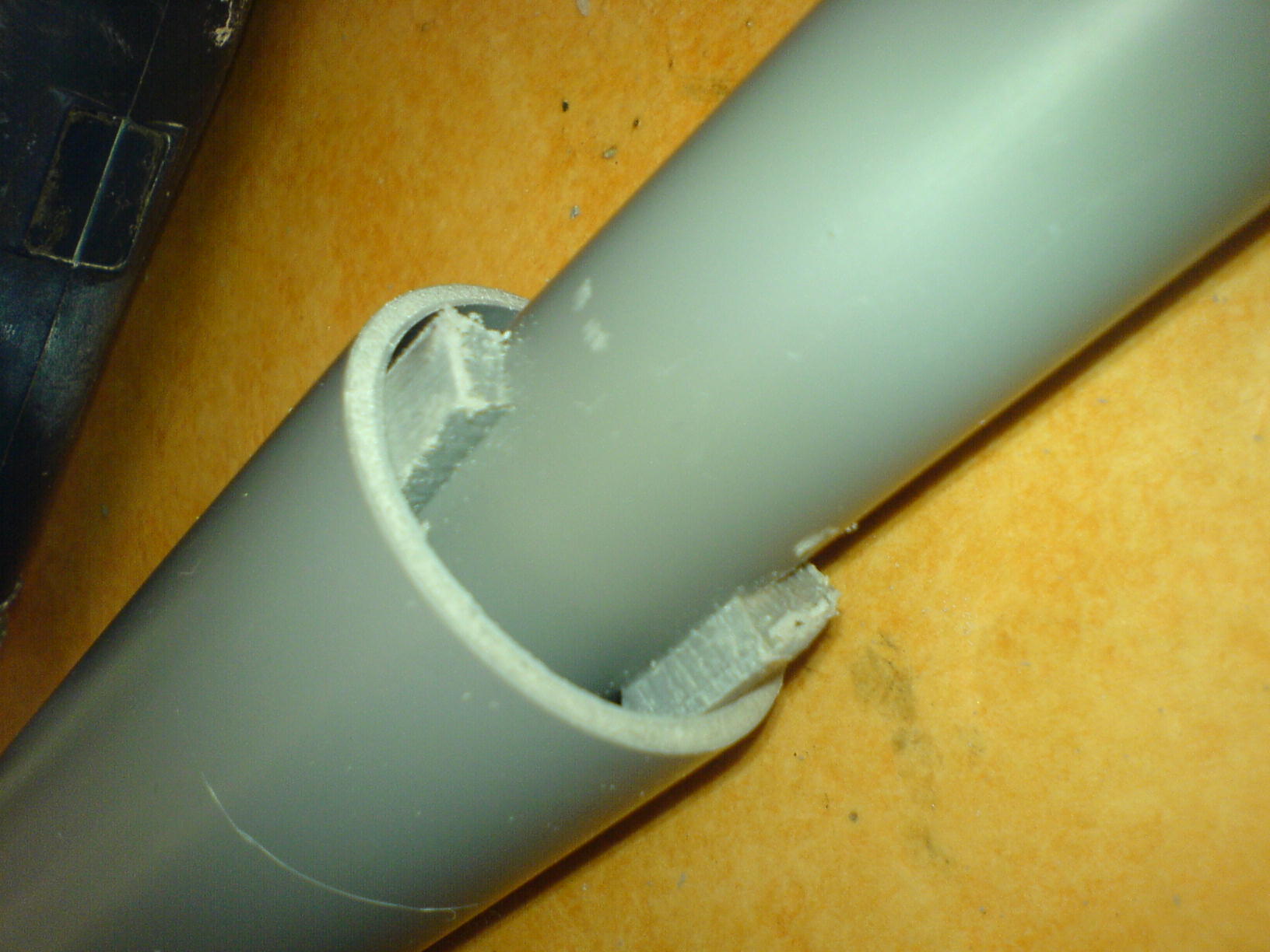

MRR
Posts: 361
Joined: Tue Feb 17, 2009 2:29 pm
I did this on one of my guns, worked quite well and is improvable

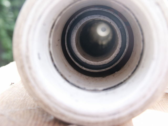

psycix
Posts: 3684
Location: The Netherlands
I used pieces of fittings.

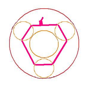

On my Mouse Musket I looked for a simple and cheap way to do it. I didn't get a photo. I took some Polyethylene tubing like they use to connect ice makers and cut 3 pieces an inch long. Mid length I drilled holes crossways through it and simply zip tied it to the barrel about 6 inches from the breech. they compressed slightly going inside the chamber. No worries about breaking, corrosion, etc.
EDIT Added modified drawing to show tubing spacers with zip tie.
1 inch barrel centered in 2 inch chamber by PE tubing zip tied to the barrel.
Tubing spacers and zip tie added.
Last edited by Technician1002 on Tue May 26, 2009 3:44 am, edited 1 time in total.
