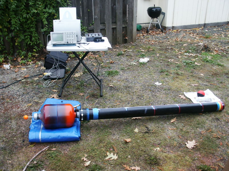

I consider the 4 inch the same way. Still I only launch light weight stuff out of it. It's a 2 inch cannon with a 4 inch barrel attached. It can still launch a foam ball at over 500 FPS. 60 PSI got it to 454 FPS.jook13 wrote:I say take a section of the pipe to the grocery store and see what cans fit well inside of it. I made a 3 inch bore (schedule 40 pvc) and found some dog food cans that work great. The cans work even better after you use them and fill them with water then freeze em.
As tech said, be carefull of the recoil. At 100 psi I seriously hurt my wrist and cut my hand wide open. Worth it, but it sucked.
Tech... I dont think your 4 inch barrel counts. I consider it a 2 inch since that is the flow of your valve.![]()
The one to watch out for is the 3 inch barrel on that thing. It about knocked me on my behind, even when I braced for it. I got a nasty bruise on my thigh where I braced the breech of the tank. Without the restriction of the 2 inch valve, the 4 inch would be a hazard to hold with anything heavy in it.

This was at 60 psi. And I am sure that your valve will be more impressive.
