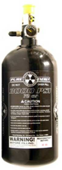

I got me a pure energy 3k tank w/850psi reg and an inline reg to drop it between 200-500...

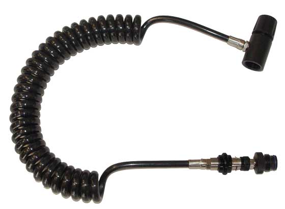

I'll see if i can get some pics of my tank and reg setup sometime today...
here's internet pics of the components I'm using...

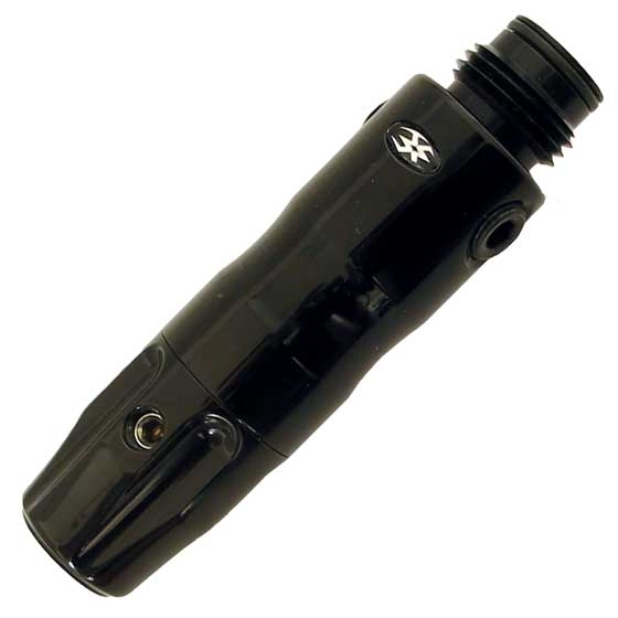

mobile chernobyl
Posts: 760
That's the empire Inline Regulator.
