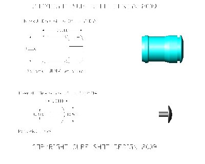

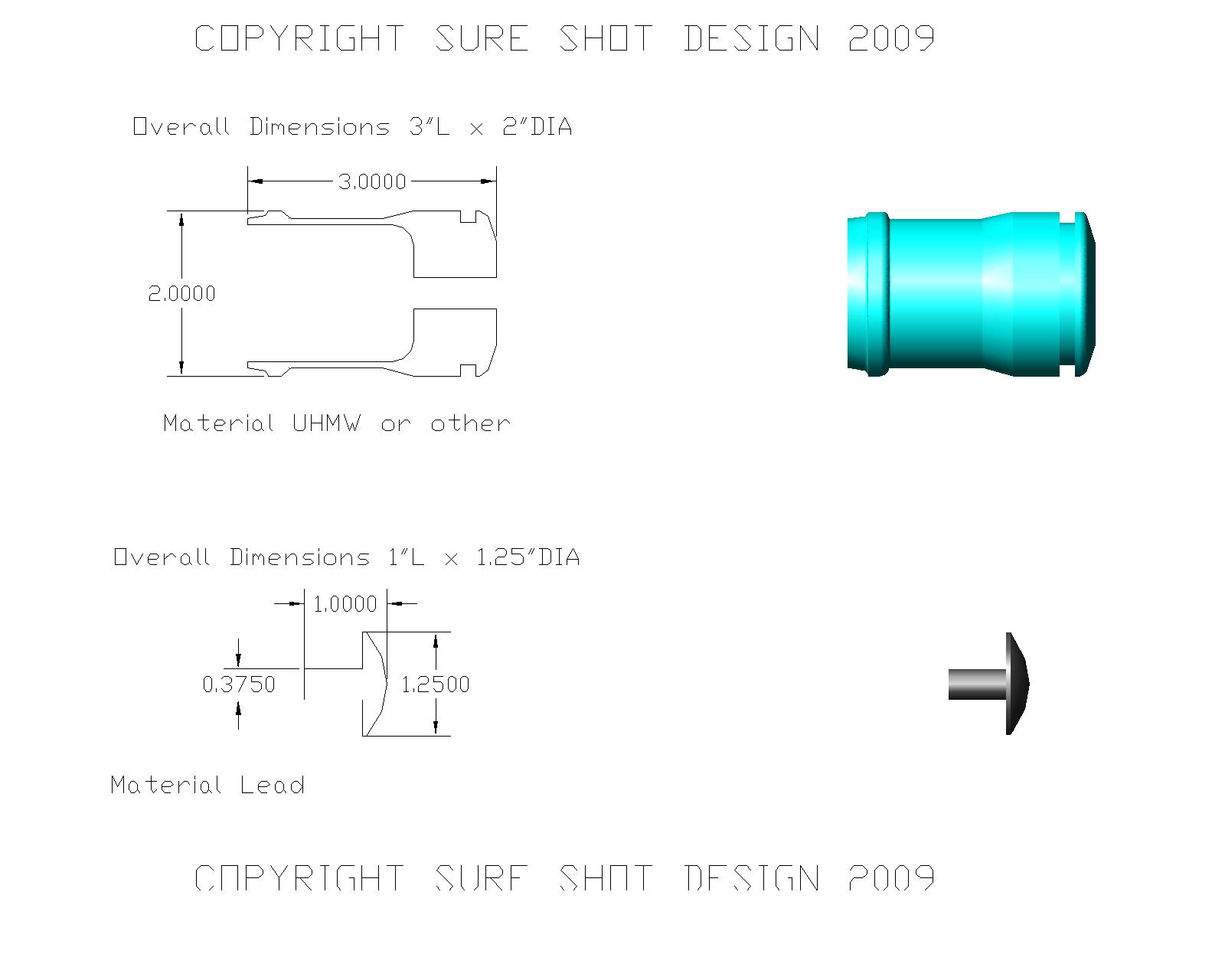

We've had this in the works for sometime, and finally we're able to get a good test session today. We recorded 500FPS at muzzle with our test BL-520. We started with 9 UHMW rounds and 12 lead caps and we're able to shoot the entire video session with 5 UHMW still re-usable.
They drill straight as a laser out 50 yards. 80 yards its dropping 3 feet and 100 yards dropping 9 feet.
Specs:
Total Weight = 135 grams
UHMW Length 3"
Total Length 3.25"
Compound Rounds from Sureshot

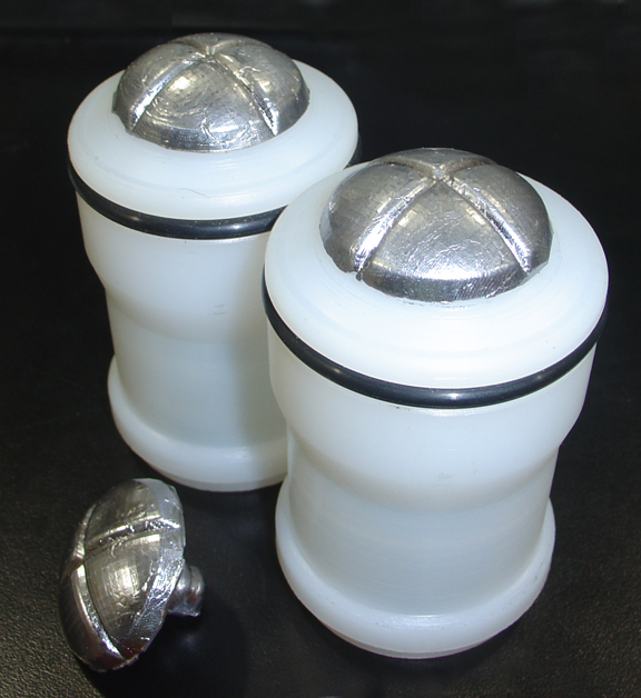

Yes, and 2.5" too.spudtyrrant wrote:those are ....... AMAZING i like those much better than the uhmw round(which was good in itself) i might just have to buy me some of those. Do you plan on making them in the same size as your original rounds?
- Gaderelguitarist
- Corporal
- Posts: 580
- Joined: Sat Aug 16, 2008 9:56 pm
- Location: Columbia, MD
Are you planning on making a round with a harder, sharper nose for piercing purposes? I think that would be the next step.
These are great though! I actually made myself a couple of the plain UMMW on my lathe and they pack one hell fo a punch.
Has the lead insert ever flattened upon impact?

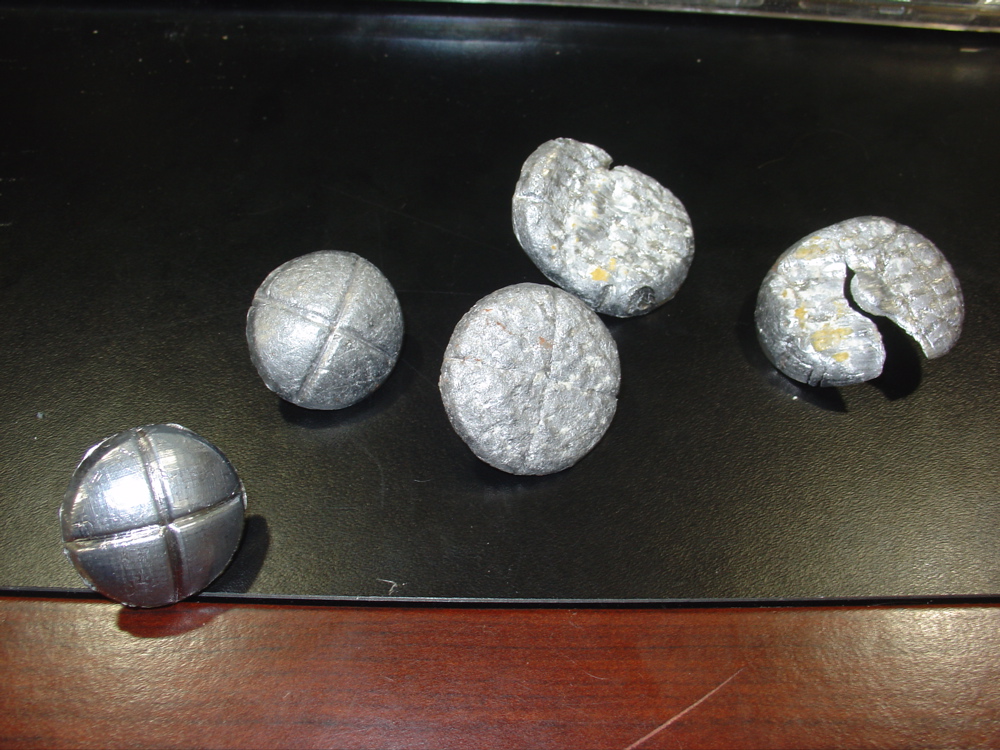

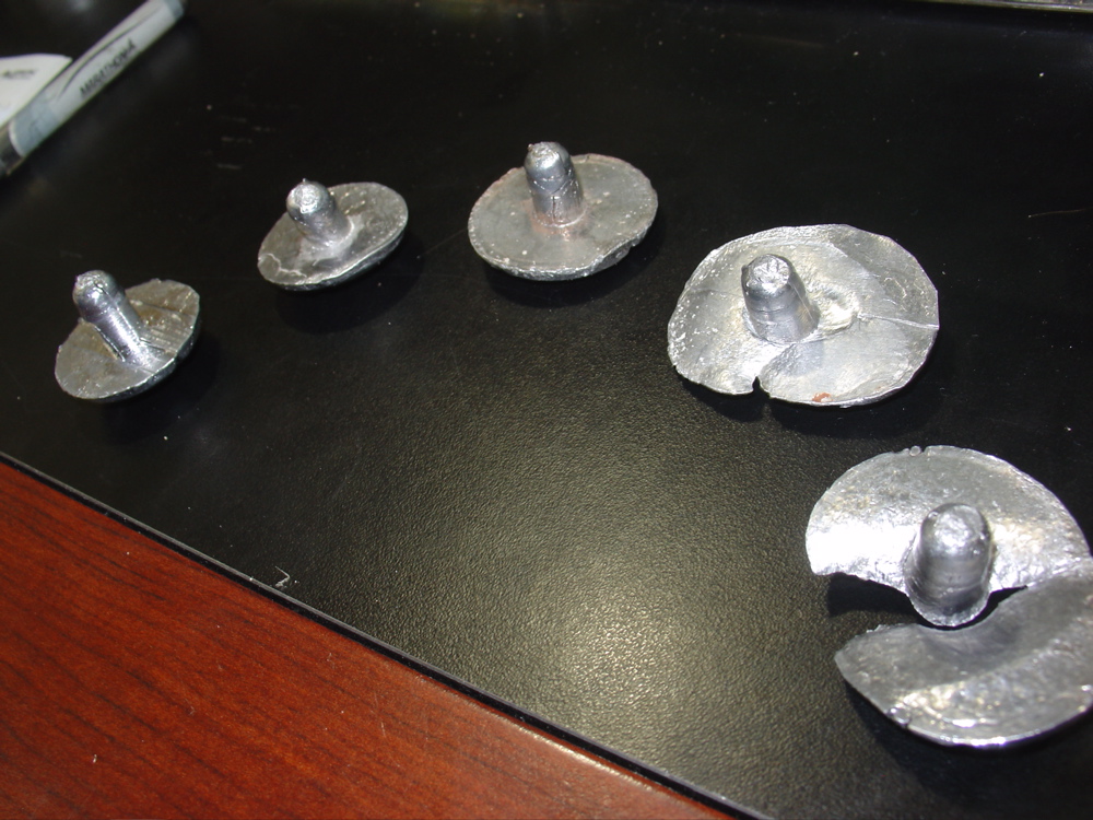

I wish the video had shown the effects of a hard impact, because I've seen lesser guns pancake led.
- Technician1002
- Posts: 5189
Would be nice, but the video was for the flight accuracy. For that it is fantastic.pizlo wrote:I wish the video had shown the effects of a hard impact, because I've seen lesser guns pancake led.

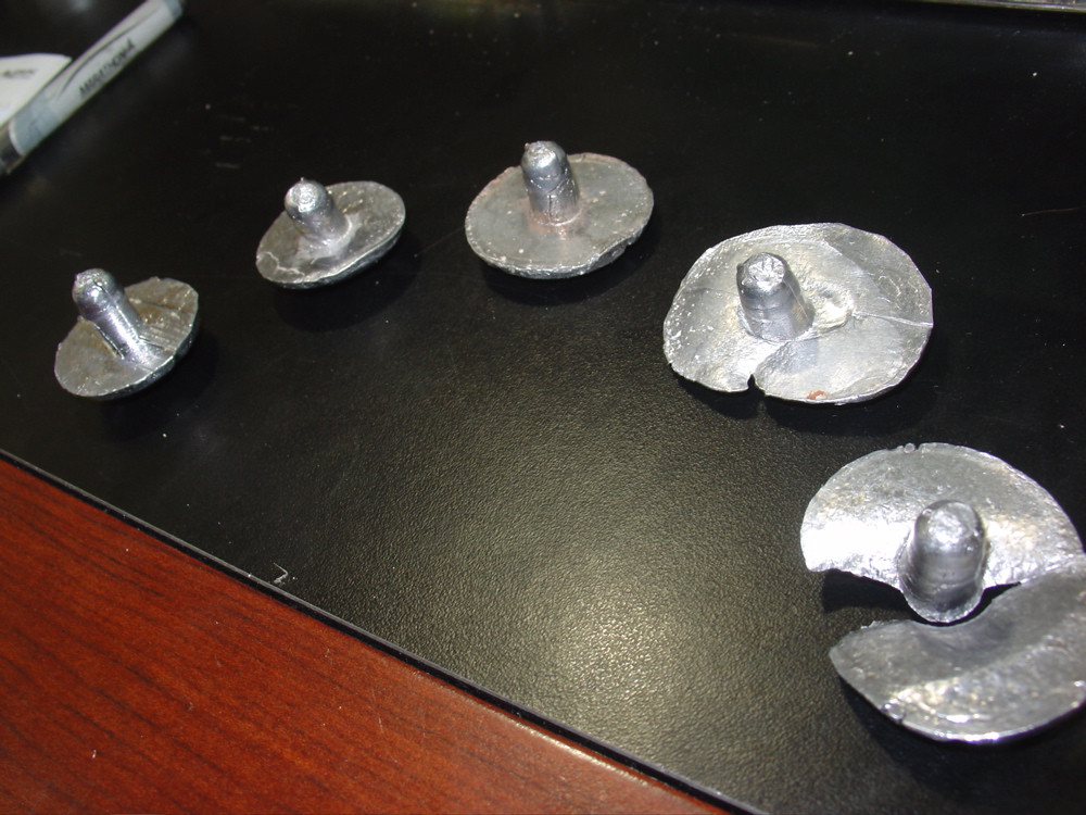

Here's some photos of the recovered lead. Notice the variance depending on distance and object struck. The left one is un-fired for reference. The real flattened ones were from hitting the carpet right where its draped over the boom to get the initial sighting dialed in. There is some carpet embedded in the lead. The carpet did a great job slowing the rounds down and allowing them to be re-usable.Gaderelguitarist wrote:Are you planning on making a round with a harder, sharper nose for piercing purposes? I think that would be the next step.
We will get some damage video up soon.
Right so the plastic is good for many uses, bu for most targets (the average ones for spudders at least)the led is a one use.

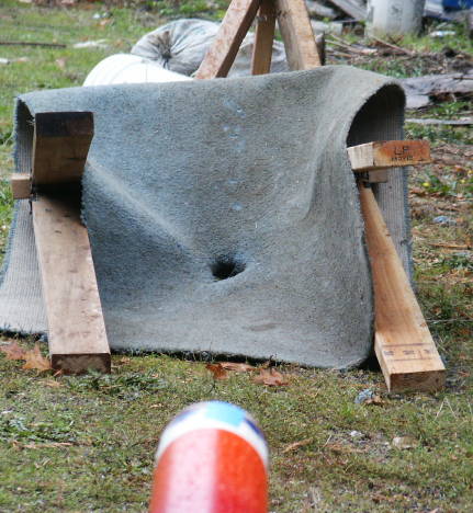

I never would have thought to use carpet for a target. That's pretty smart.
so many muchness
I use carpet as a ricochet catcher ^^
