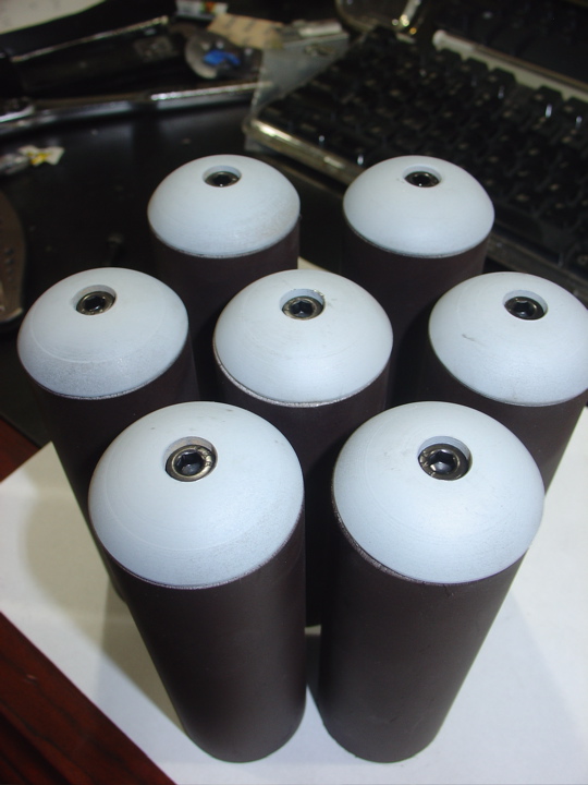

1.7" PVC compound rounds
jagerbond
Posts: 286
Location: Hawaii
CP-CG differential = 1 caliber for excellent stability
Designed for use with 1.5" SDR-21
Construction
PVC puck with center tapped hole, 5"s of 1.25" SDR-21
Custom turned steel cap
The entire video above was shot using only ONE round! Target distance = 50 yards.
We will be retailing DIY kits for $20 which contain 6 steel caps, 20 skirts, 20 center drilled pucks, 20 socket cap screws. Assembly requires PVC glue and a few seconds.

Looks like you found the right length/weight combination to achieve that "magic number" for flight stability.
The skirt tubing end, held up quite well.
Looking forward to pneumatic operation! HINT HINT :D

i will have to buy a set of these $20 for 20 great deal how many prototypes did it take to to get that awesome flight stability again great product p.s. how many shots do you think the center drilled pucks will last

jagerbond
Posts: 286
Location: Hawaii
spudtyrrant wrote: how many shots do you think the center drilled pucks will last
It will depend on the target. Using carpet or wood as a backstop I think you could re-use all day. Usually the failure point is the tail.

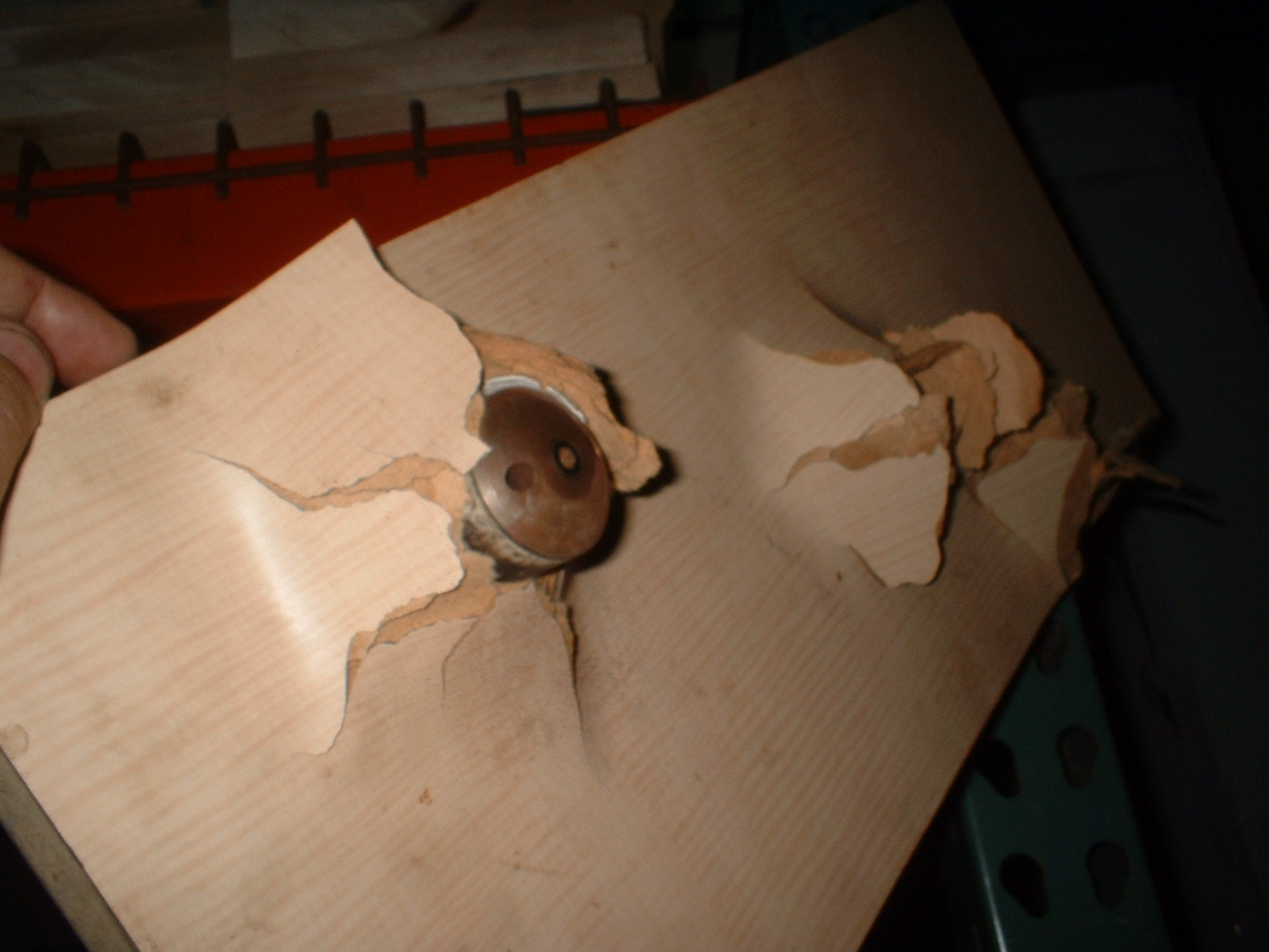

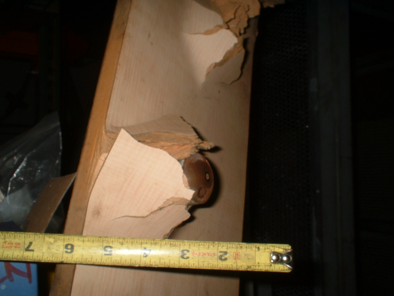

jackssmirkingrevenge wrote: Great stuff, good to see that it survived impact with MDF too
The MDF still has the round embedded in it and hangs on the shop wall. I forgot to take a pic when I left on Saturday. Maybe USGF will take a photo and post for us.
Thanks for all the comments.
I hate when I gotta make robots. Got a lot of Zombies too. OK, here are the pictures:
USGF
This a very much a family show
bonafide 3/4" thick MDF with Melamine laminate, 1.7" round

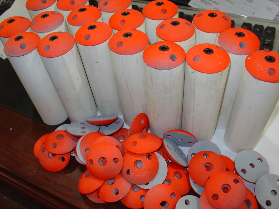

Supplies for the 4th. muhahaha

jagerbond wrote:Supplies for the 4th. muhahaha
Tie on some glowsticks on the inside with mason line for some night tracer rounds. The pink and orange ones are great for states that don't allow fireworks that flies into the air (like Oregon). Did that one year and attracted all sorts of attention. It wasn't fireworks. :D
