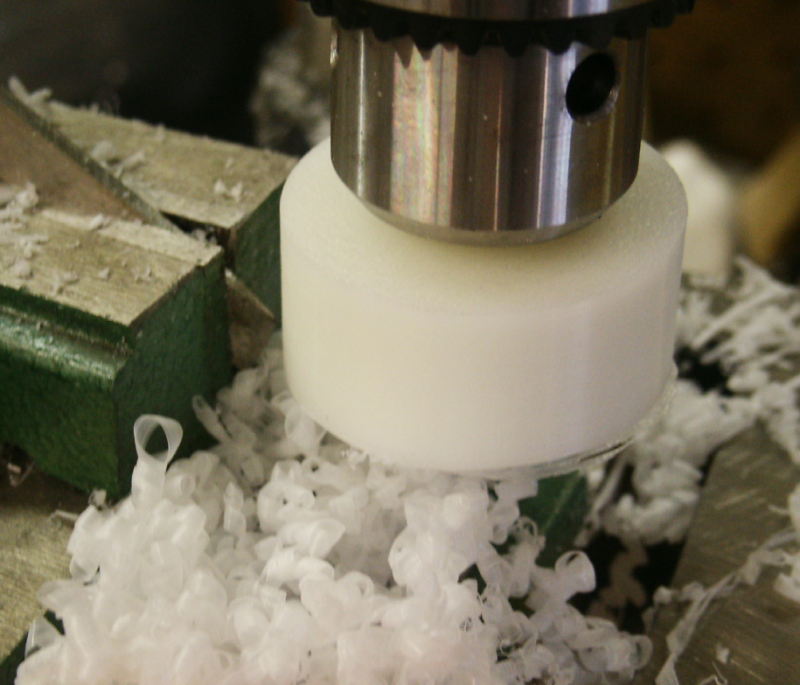

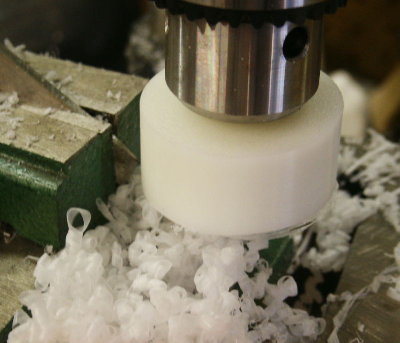

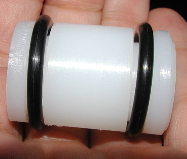

Parts with rings can be made on a drill press.
The two pictures are two different valves. One is a piston for a coaxial called the Mouse Musket and the other is a QDV style for the Marshmallow Cannon.
The rings are floating and do seal well.
The materials are HDPE and UMHWHDPE.
- O rings on 1 inch valve Note away from the chuck, tool chatter was a problem.
- piston rings.jpg (29.92 KiB) Viewed 3338 times
