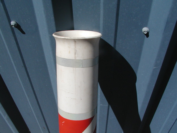

use sdr 26. just order from gort and with a short barrel you wont have to worry about barrel flex
hubb017 wrote:I considered putting in the 2.5" thinwalled pipe, but several tings kept me from doing that. This sort of pipe is a lot harder to obtain compared to a piece of 3" pipe. Also, because it is a thin pipe, it will need to be sleeved, and I am not familiar with a sleeving pipe for it.

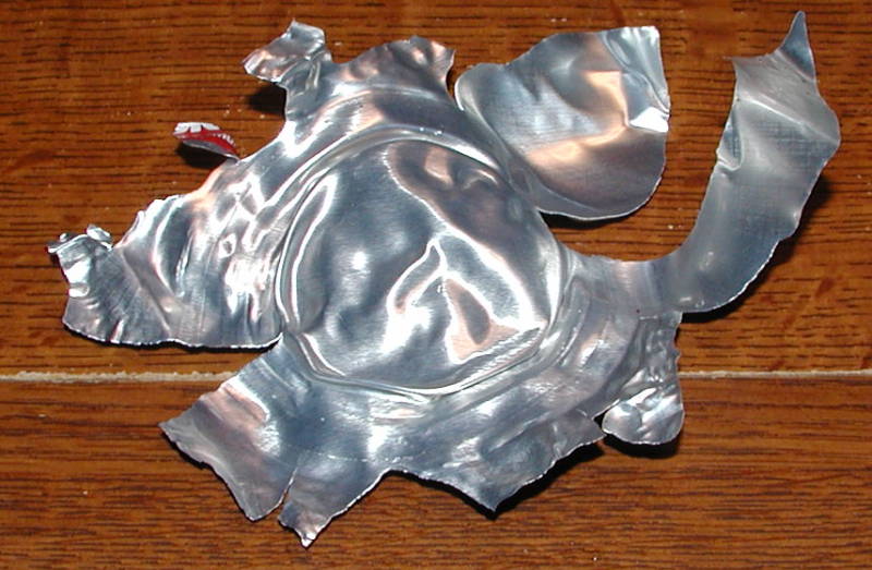

Un-sleeved SDR26 works fine. I tested a 7 foot length un-sleeved with no problems. :D
But watching a full can of soda smack a brick wall and explode may just be worth it.
Yes, the splat is impressive.
Much of the side of the can is tiny shrapnel.
