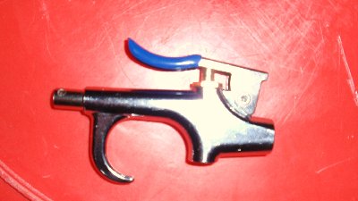

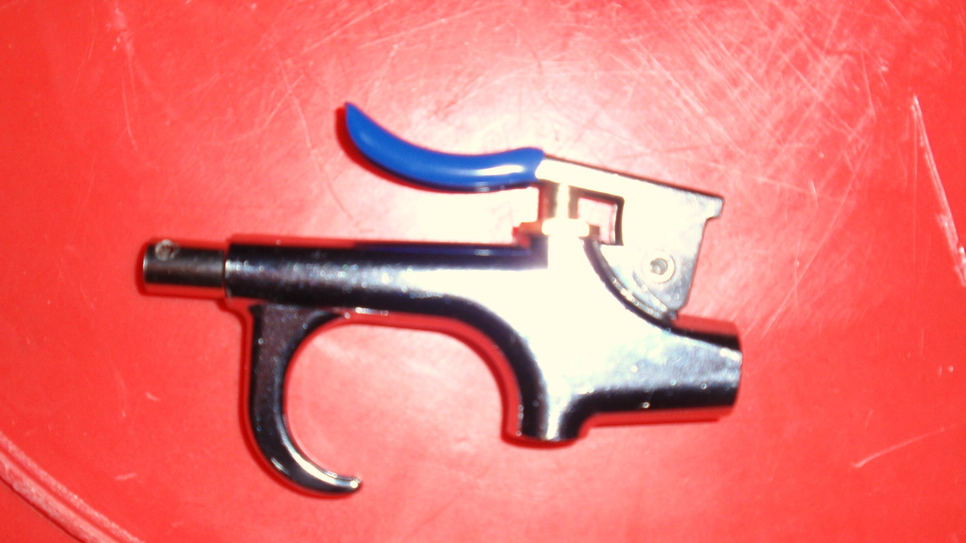

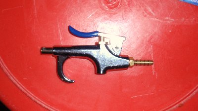

I'm working on my first spud gun and have just bought a blowgun and 2
1/4'' hose barbs for connecting the sprinkler valve to the blowgun. My problem is, the barbs are too small for the back of the blowgun. Did i get the wrong type of blowgun or barbs? Or will wrapping the threads with teflon tape be enough to allow for a good seal?[/img]
way too big
way too big

campbell hausfeld blowgun

it look like 1/8npt and a 1/4 hose barb
you need 1/4npt and 1/8 hose barb

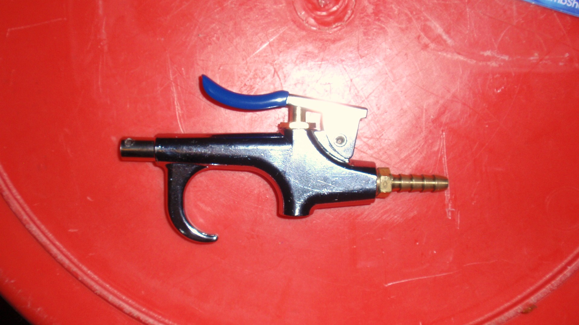

Find a hose barb with the correct I.D. of your hose and 1/4" male NPT threads on the side. That is the thread size of the blowgun.

Any way, Igot new barbs with 1/4" MIP (is MIP the same as NTP?)
but now, it only threads 3/4 in before it locks up. help?
