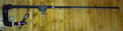

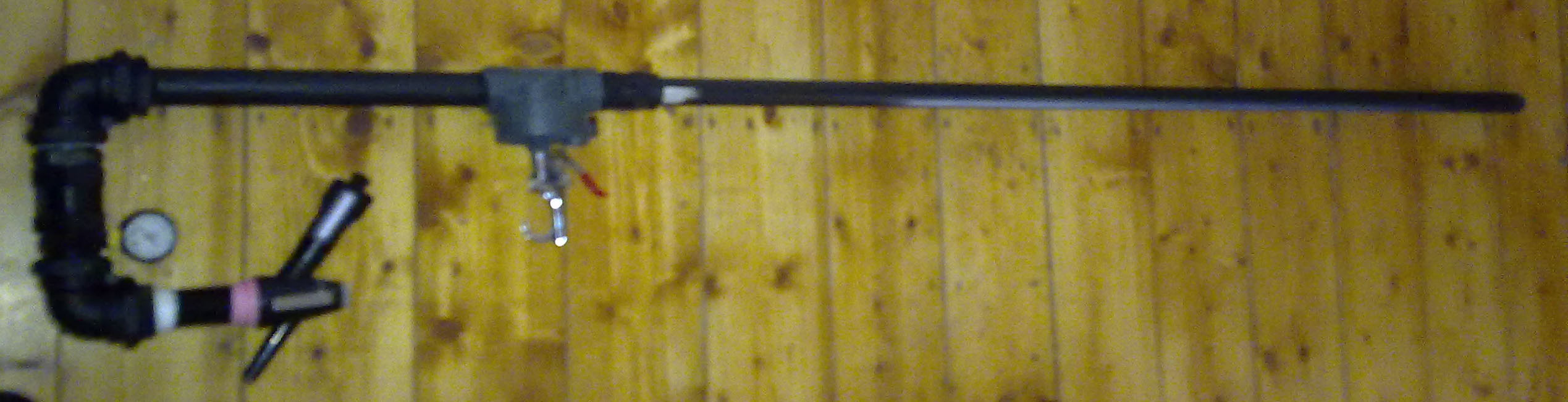

This is my First attempt at a Soda Cannon.
After making one or 2 pneumatics i began thinking of ways i could load it without the aid of a compressor.
After purchasing a cheap bike pump and only being able to reach about 50-60psi, I abandoned that idea.
Below are images of my Soda Cannon.
I have taken the head of a an old soda stream syphon and fitted it to the end of my 1 1/4 inch chamber.(with much thread tape as the threads arent matched)
This allows for on the fly loading with Soda Bulb cartridges.
The addition of a different sized barrel also allows me to fire the empty bulb as a bullet. its not bad, the bulbs are fairly areodynamic and travel through the air well.
This chamber size holds 375m of water and has been fitted with a psi guage so we can see how much pressure is in there.
atm one bulb gets me roughly 100psi, the only variable is the syphon head is old and sometimes the valve leaks a little.
Adjustment of chamber sizes would give diff psi, or the addition of a second bulb.

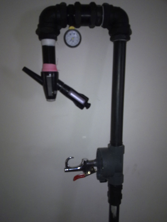

close up of chamber and trigger.
hi
Posts: 1619
looks pretty good to me.
Has thanked: 581 times
I would make the chamber smaller, for a given mass of gas, small chamber and high pressure gives more power than large chamber and low pressure.
The numbers don't lie ;)

Cent wrote:im thinking maybe up to 200 psi would be safe?
From what I can see the weak link in your launcher is the sprinkler valve. It should be rated to around 150 psi, this doesn't mean it will explode at 200 but if you're going to go higher you should be using a metal QEV.
