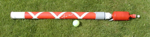

This launcher has a 100 yard tennis ball range.

- This little 1 inch piston valve tennis ball launcher can launch rolled up t shirts 200 feet.
