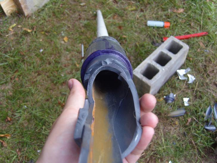

I was planning on entering the contest, but I had a little problem with my gun.

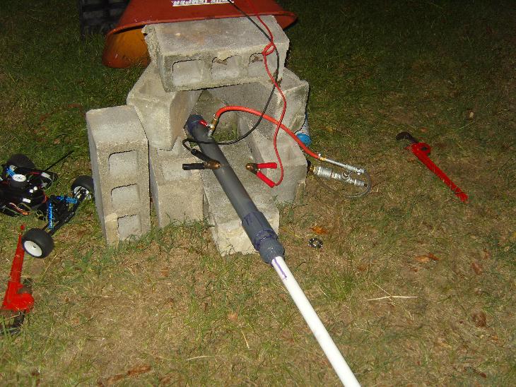

It is 1.5"sch80 pvc sleeved in 2" sch 80 pvc. everything had at least two layers of sch 80 pvc.

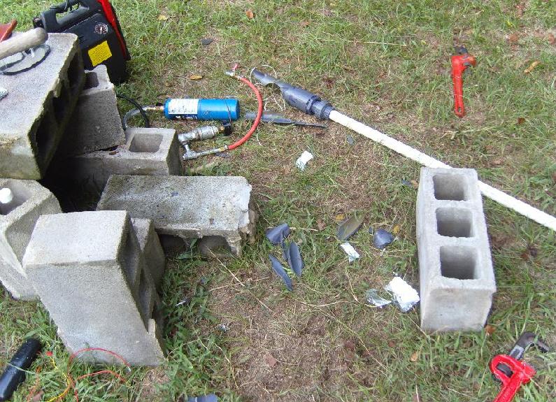

Me and Drex fired it seven times before it blew. one 2x, one 4x, two 5.5x, and three 8x. On the first 8x shot it put a 10" 19 oz nail through 4 pieces of 3/4" plywood. We expected a max chamber psi of about 900psi so we made a bomb shelter out of cinder blocks just in case.
The good news is that the remote ignition and the bomb shelter worked perfectly.

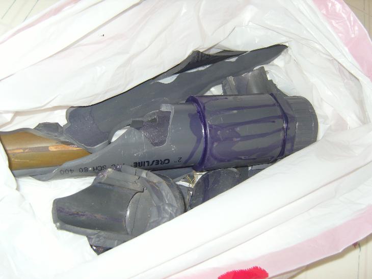

After seeing the copper barrel with a big blister, I wouldn't be surprised if it was some kind of wave front. Air is not safe, but high pressure combustion provides uneven forces. It's much like hitting it with a hammer.
Wow.. Thanks for sharing the video and photos. Good call on safety first. How far did shards fly?
From the orange stain, this may have been a used pipe with rust stains. That may have had some contributing factor.
It wasn't copper. it was burnt pvc.

What you're seeing here is less likely to be DDT than it is the result of pushing an unsafe building material past its limits. It is well established that PVC is brittle and, being a plastic, has a very low tensile strength compared to that of even mild steel alloys.
Consider the case of a very large block of ice with a small HE charge placed in the middle. Even if you make a cubic metre block of ice, chances are that it will still be cracked by the charge. If you repeat it several times, you could have an absolutely huge block of ice which will still crack apart and crumble away eventually. This seems to be what your PVC is doing, as there's no way that you exceeded the tensile failure pressure with an 8x mix.
I can see this happening on high pressure PVC barrels too - even if you're building a pneumatic for this contest, something similar may happen if you run at sufficiently high pressure. As Tech said, it's like the copper barrel with the bulge.
