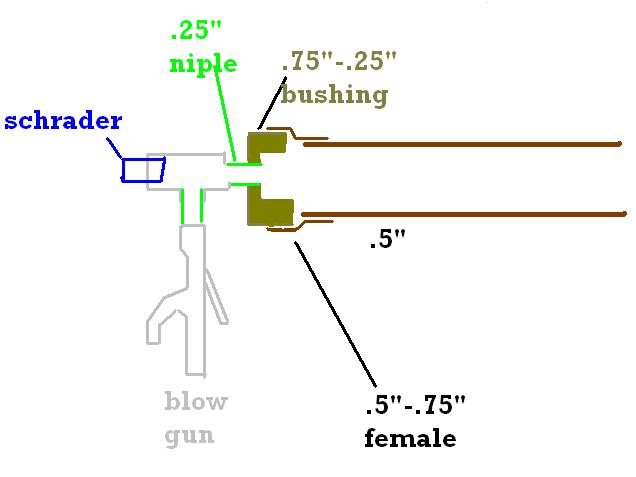

For attaching the barrel and having it centered, just use a 3/4" x 1/4" reducer on the front of the gun. Screw in a 1/4" nipple. 5/16" brakeline fits pretty well in 1/4" nipples, so with lots of epoxy it should work fine.
